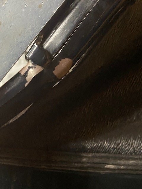

Noticed the main bow for the top on my '27 touring is bent at the joint following the final tour of the year. The car had sat for several years before I took position last year. So the joints are very stiff and difficult to move
My thought are to take a piece of angle clamp it to the bow and then use another to pull the bow to the angle. Better ideas? How can you limber up the joints so that they move easily other than use?

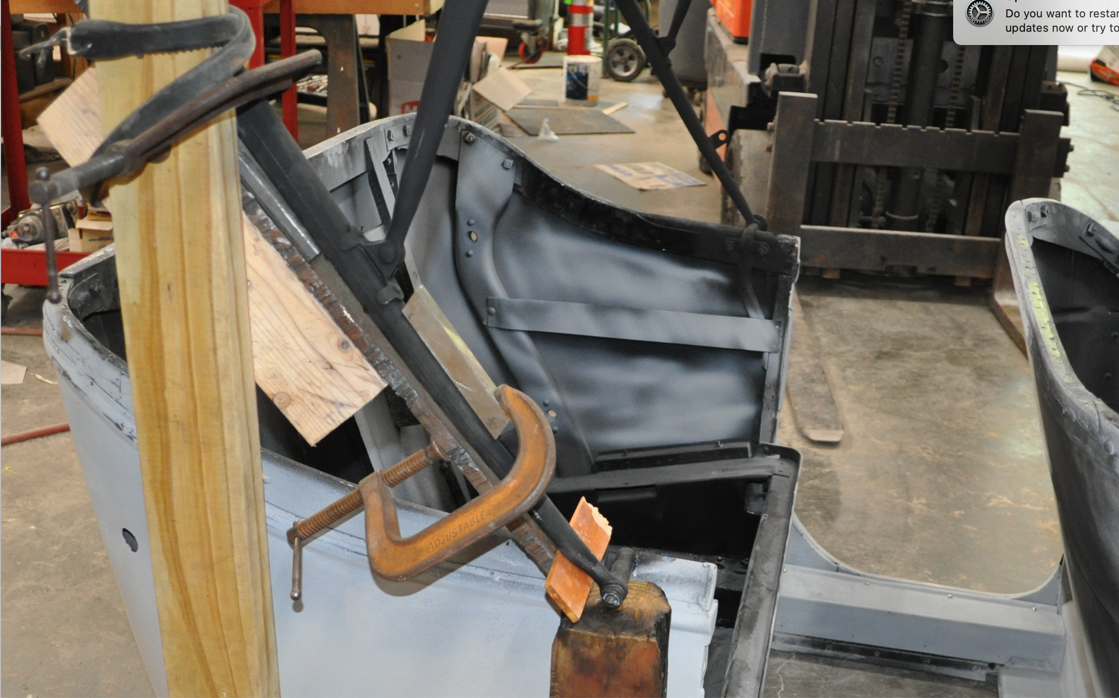

Mine was not as bad as yours. If you do try to straighten it, you will need to over shoot, as it always bends back a little. (see the shims in my photo).

Steve Thomas wrote: ↑Wed Nov 25, 2020 3:28 pmNoticed the main bow for the top on my '27 touring is bent at the joint following the final tour of the year. The car had sat for several years before I took position last year. So the joints are very stiff and difficult to move
My thought are to take a piece of angle clamp it to the bow and then use another to pull the bow to the angle. Better ideas? How can you limber up the joints so that they move easily other than use?large bow.jpgbow 2.jpg
Hard to believe the joint could be stiff enough to do that. Is it possible that the car was placed in an enclosed trailer, with the top up? I've seen damage like that when the car is left with the top up and the trailer has gone over some rough road. The car can bounce up and down more than one might expect. That bow forms the tallest part of the top. Striking the top of the trailer would be a great way to make that kind of damage.
Your straightening suggestion is what I would do. Consider adding some heat as well, to prevent cracking the bow.

Steve, your angle idea should work. I would do the clamping cold. Once you have it down straight, then some heat applied will relieve stresses in the bend and it should hold its shape. Heat applied before the straightening is likely to deform the metal at the bend.
I agree that the bend is likely to have been the result of a down load on the third bow, rather than stiff joints. If you look carefully, above the major bend there is a slight curve in the opposite direction.
