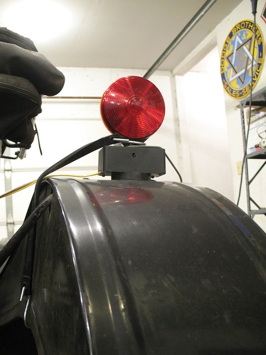

I adapted HF magnetic trailer lights and set them on my fenders. I had to use welding rod hooks and bungees to keep them from bouncing off.
Since one of them shook apart on a country road I've decided to do something else for tail lights.

I purchased a set of these. Fully remote. Have magnet and also strap to secure

Get a second 26 light and put it on the right fender and convert the sockets to double filament. Most people will not know or care that the second light did not come on the car. If you don't want to do that then put a plug behind the spare tire and use the U-Haul or Harbor Freight magnetic lights. As Steve said, they might jump off on a rough road, the fenders really shake. They may do better stuck on the side of the body.
