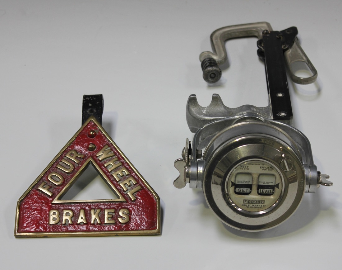

I am a bit old school and believe in only using period correct accessories on the Model T such as this auxiliary brake set up......
