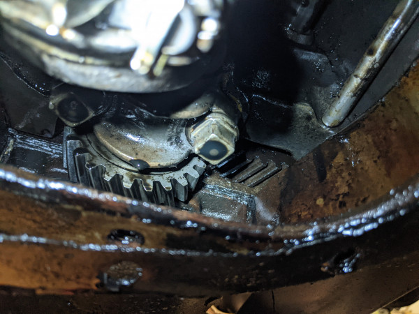

ok, I got the hogs head off last night, finally. it took me an hour and a half but i did it!
the drums are loose and have a good amount of play in them, about enough to stick a butter knife in-between. the triple gears look fine with only slight play in all but one, which rocks side to side with about a fourth inch movement. i believe the tooth came from a drum, its a little less than an inch long. could this be possible? the flywheel is torn up in some places as well. it looks like the cotton brake band got obliterated and is in clumps inside the engine and transmission. drums are not discolored and are still smooth, except the brake drum, which has grooves in it. i didn't see any cracks. there is still a slight amount of oil in the pan.

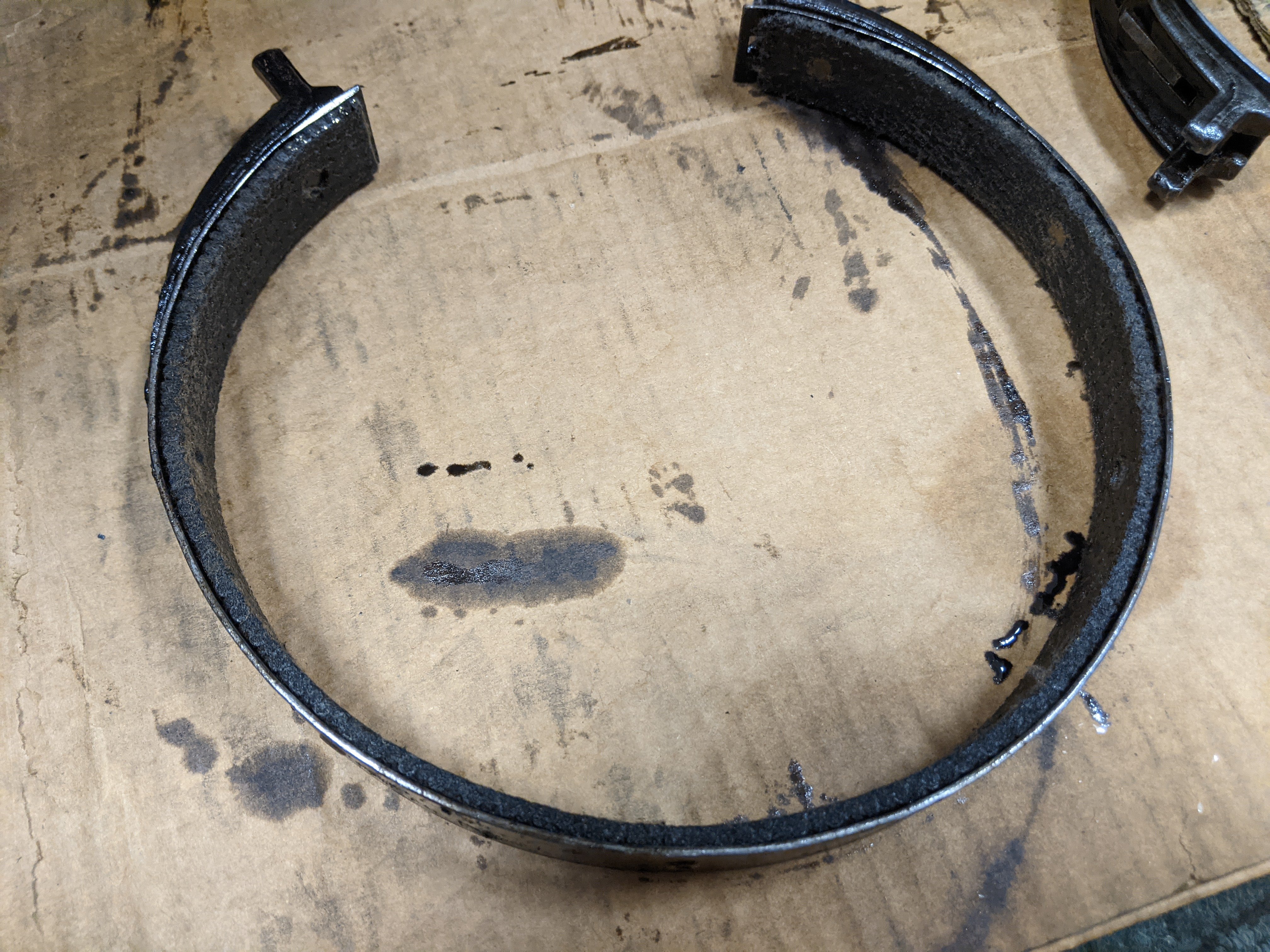

by Mr man » Fri Dec 11, 2020 11:28 am

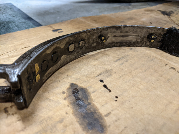

by Mr man » Fri Dec 11, 2020 11:32 am

Clearly someone has been in there - aluminum pistons, oil dippers, etc. Take notice of the fiber cam gear - unless you can verify it's "an era" macerated one, you might consider replacing that with an original steel or aluminum gear to prevent a catastrophic failure resulting in "found on road dead" it won't take long for the generator to remove some teeth !
The bands appear to be late production Scandinavia "tar babies" - not the best on the market IMO. Can't distinguish what the metal chunk is - did you verify it was a triple gear tooth or ???

The first photo of "the chunk" appears to have a gear tooth mark - interesting !
That by itself demands pulling the engine, taking off the pan, and removing the transmission. I expect the wobbly triple gear is seized and has wrecked the flywheel. I don't recognize the "tooth", but I suspect it may be a piece of drum and was part of chewing up that band lining. The engine may be perfectly OK except for needing all the band debris cleaned out of it, but you will at least need to pull the oil tube for a thorough cleaning. Diagnosing an engine's condition from photos is beyond me. I would want an experienced Model T specialist to inspect it.
If that is indeed a fiber timing gear, in my book there's no might consider about it. Don't gamble that it may be OK. Get rid of it. Replace it with original steel, new aluminum, or new bronze. I believe bronze is best.

If the metal piece is a gear tooth, it's not from the triple gears. The rule shows it to be almost 3/4" wide, wider than the teeth on even the earlier tree piece gears and the driven gear. The transmission needs to be stripped to investigate.

Pretty sure it's a tooth from one of the drum gears, (sun gears).

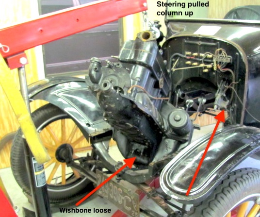

ok, I'm going to borrow the clubs engine jack today, and hopefully pull the engine this afternoon and really get going somewhere. I'm still not totally sure how to disconnect the universal joint, however. could someone tell me how that works?

Just remove the four bolts that attach the drive shaft housing to the transmission and the u joint will slip out of the transmission as you pull the engine out.

Don't forget to drop the wishbone.

by the way, does anyone know if I need to remove the steering column to remove the engine? or can the motor be maneuvered around it?

I don't remove it all the way, but I undo it at the bottom and at the firewall and set the steering wheel back on the seat. I've never tried it with the column in place because it looks to me like it would be more hassle than it's worth. See Pages 50-52 in the Service Manual.
As you remove the various nuts and bolts it's a good idea to put them in little bags or envelopes and label where they go. Eventually maybe you won't need to do that, but the first few times before you learn to recognize everything it will simplify reassembly.

Like Jeff posted, pull the steering column up and behind the dash, you need that space at the lower frame to pull the motor. Lots of little stuff to remove, plug and gen, starter wiring, drain the rad, and remove it with the hoses attached to the radiator, by removing the upper and lower outlets. Remove the fan and timer with wires. And remove the metal hood shelves, makes it easier to first slide the motor out with the pan ears gliding on the frame rail. A bit of grease on the frame rails too helps the slide, both out and back in.
Remove the 4 bolts at the u-joint, and remove the 4 bolts holding the engine to the frame sides, plus the cap on the motor/spring mount. Lastly, don't forget that darn wishbone, that has hung up a lot of engine pulls

This is Carson's transmission drums. The gear on the low drum is galded and broken and the bushing is scored and loose. I'm thinking not enough clearance when installed. [/size][/image]
