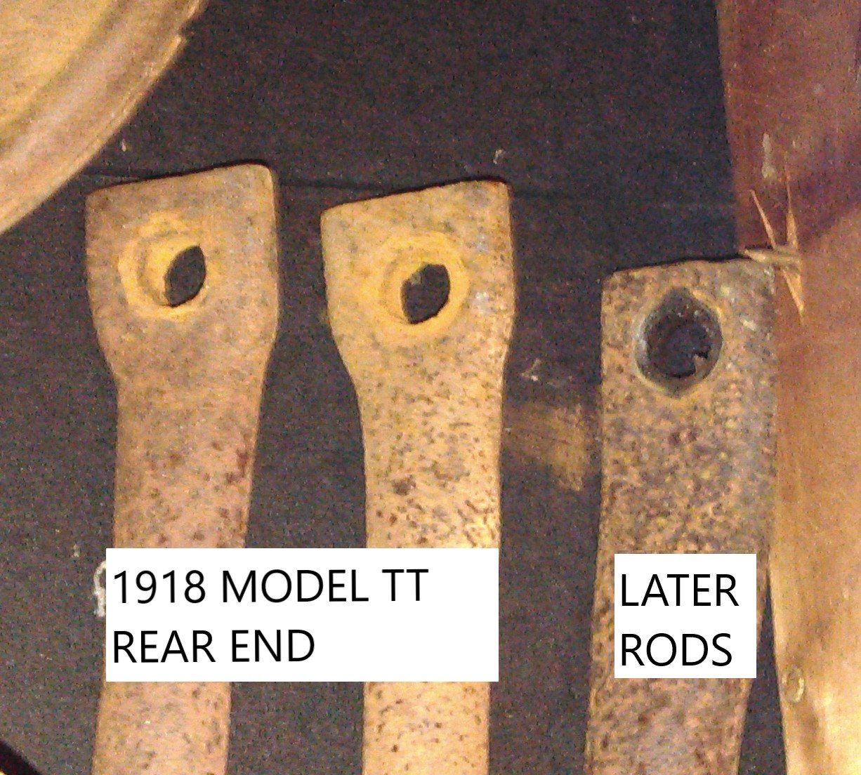

Sixth, the radius rods ends where they attach to the torque tube are larger.
