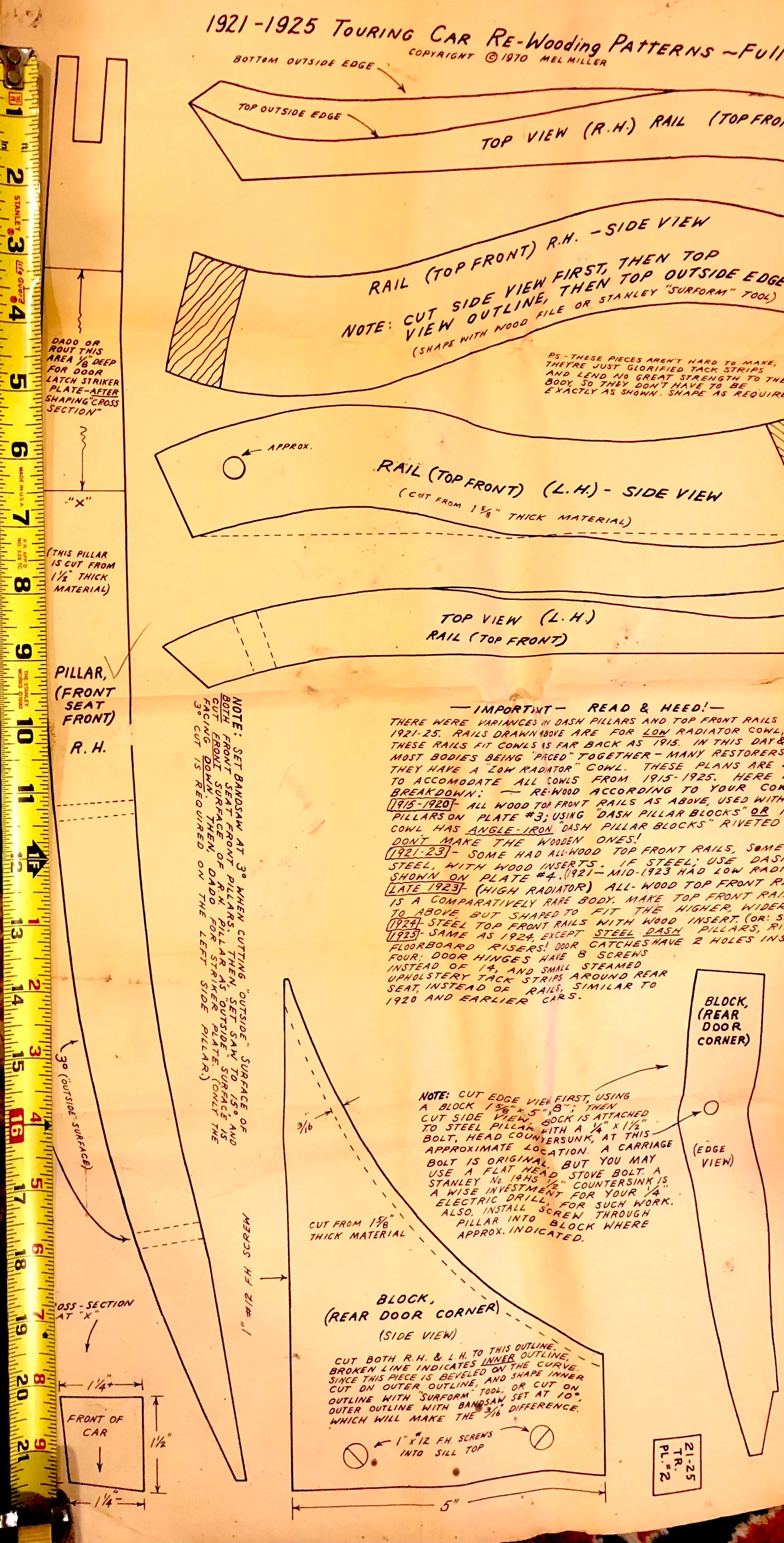

For the pillar's they are 21" approx tall on the later touring, that is the length of the pillar, the sheet metal would give you the finished height.
Mel's plan, laid a measuring tape along side the full size template of the wood plans.

The 23-25 bodies are similar. 19-21 bodies are similar and early brass cars had several changes prior to 15. 26-27 had much less wood than the earlier ones. You need the pattern for the actual car you are working on. Note, there is some overlap during 1922 and 1923, so a car registered as 1922 could be earlier or later and likewise 1923 could have a 1922 type or 1923 type body. I am not sure about overlap on other year models.

Thank you Dan, I check my plans and it is the same. That is the only piece that came from another touring body that I can reuse if needed. :)
