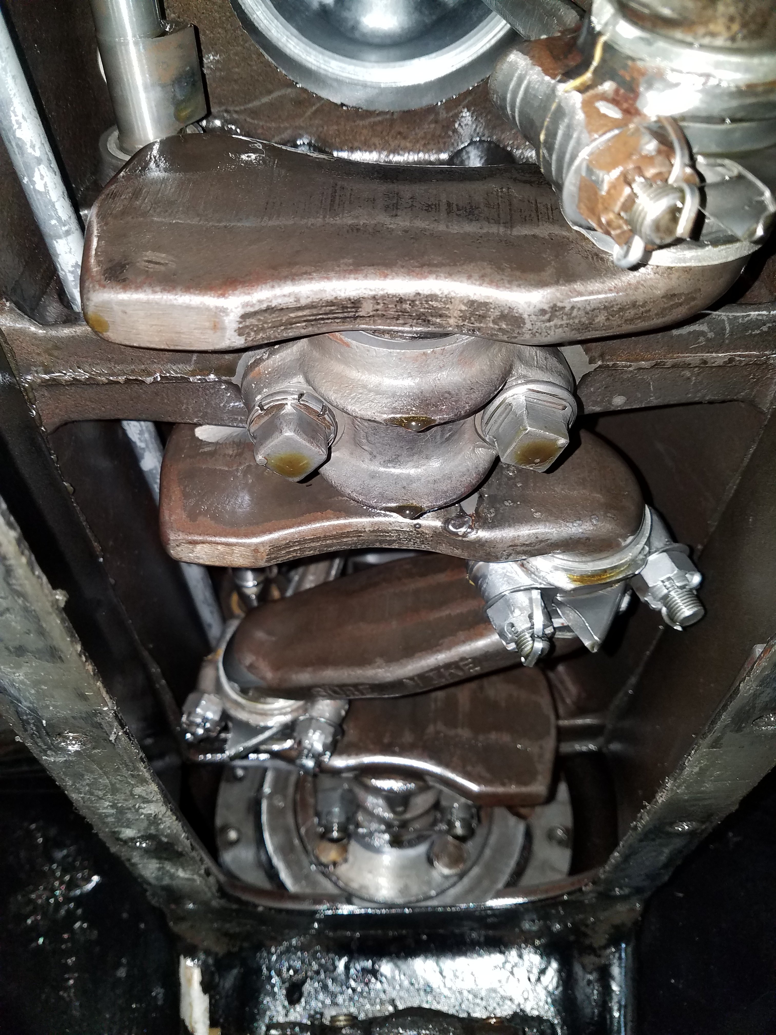

Joe I have a sure mike crank in my 15 touring, that my father found in a junk yard back in early 60'. He had it clean up and it has been the car ever since. The motor was rebuilt by Pat's restoration a couple of years ago. It does help with the vibration and smooth out the engine.
Fitz

I have a 22 Canadian block with s SureMike crank.
I ground the journals and reinstalled it when I restored the engine some years ago. I'm running a 250 cam and a Z head with aluminium pistons.
I have had no problems, the engine is a good performer on hills and is quiet and reasonably vibration free.
