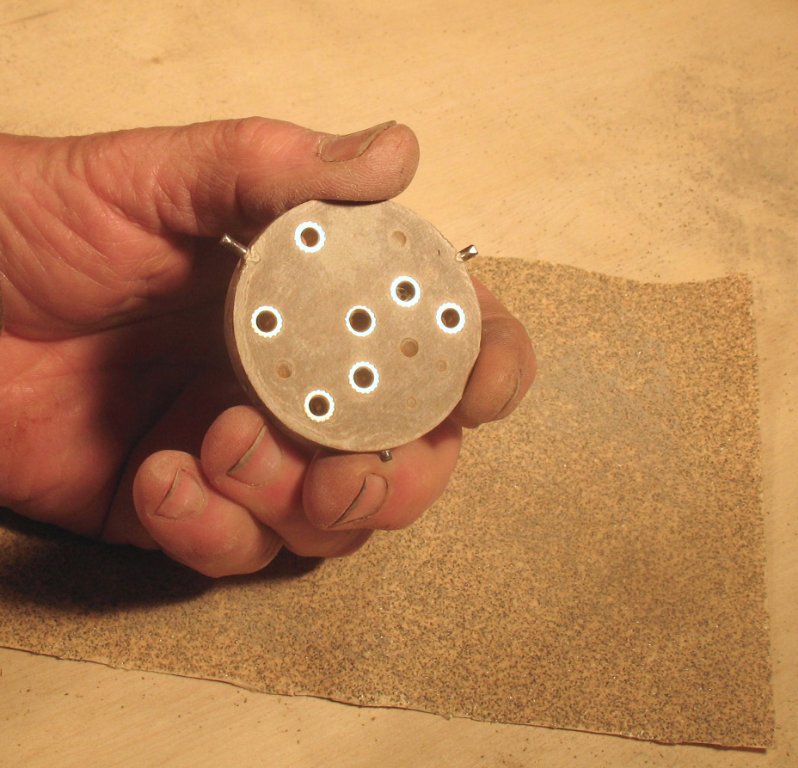

I agree that the problem could in the switch. The backing plate is made of sort of a thick cardboard that sometimes is warped so that the contacts don't work as they should. If that's the case you can flatten it on coarse sandpaper. You may need to deepen some of the dimples carefully with a drill bit. Sometimes the back plate is held by tabs you have to bend open. You should anneal them (turn them red and let them cool) before you bend them closed to reassemble the switch.
This back plate is held by pins, not tabs. There are slight differences among switches because Ford bought them from different suppliers.
