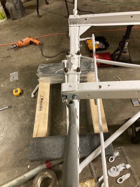

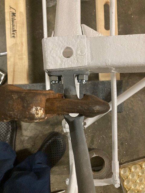

One of my front fender hangers is bent. I put a big pipe wrench and extended it with a pipe for more leverage. That straightened it a bit but it still remains somewhat bent. Is there a better way? -- IV

You may have to use some heat.
those brackets are forgings , so they can be heated with no problems .

First of all, thanks for the quality photos. It appears there are two (2) bends in your hanger. The first looks like it is right at the point where the attachment plate starts but before the headlight bracket hole, the second is about 6 to 8 inches up the rod from the headlight bracket hole. Both can be heated to ease the straightening process. I would suggest before heating the attachment plate area you insert a headlight bracket to keep from damaging the hole. Ask me how I know about creating another problem while trying to solve the first problem. :-)

Building on what Pete said...heating this to bend has multiple benefits. Less force is required to create the bend, but also heating will concentrate the bend, so that precise location and scale of the bend can be optimized. Your photo implies that your bend correction needs to happen on both sides of the fork hole.

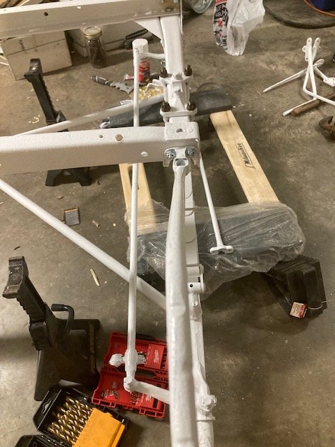

Heated it, longer pipe, tried again. It is still a little off but I am wondering if I am at diminishing returns. Is this good enough? I've included the other side which I think is straight.
Posts: 7260
Re: Straighten Front Fender Hanger?
Post by Allan » Mon Jan 11, 2021 10:24 pm
As long as the fender end is set at the same height and from the distance from the front on each side, you should be OK. If you re going to fit Ford headlights, you might have to induce a twist in the stem for that side, so it points forward squarely.
