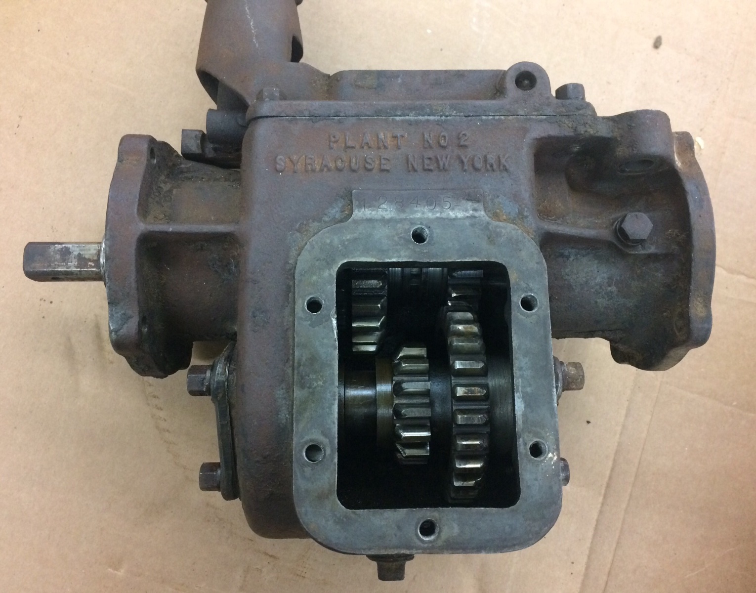

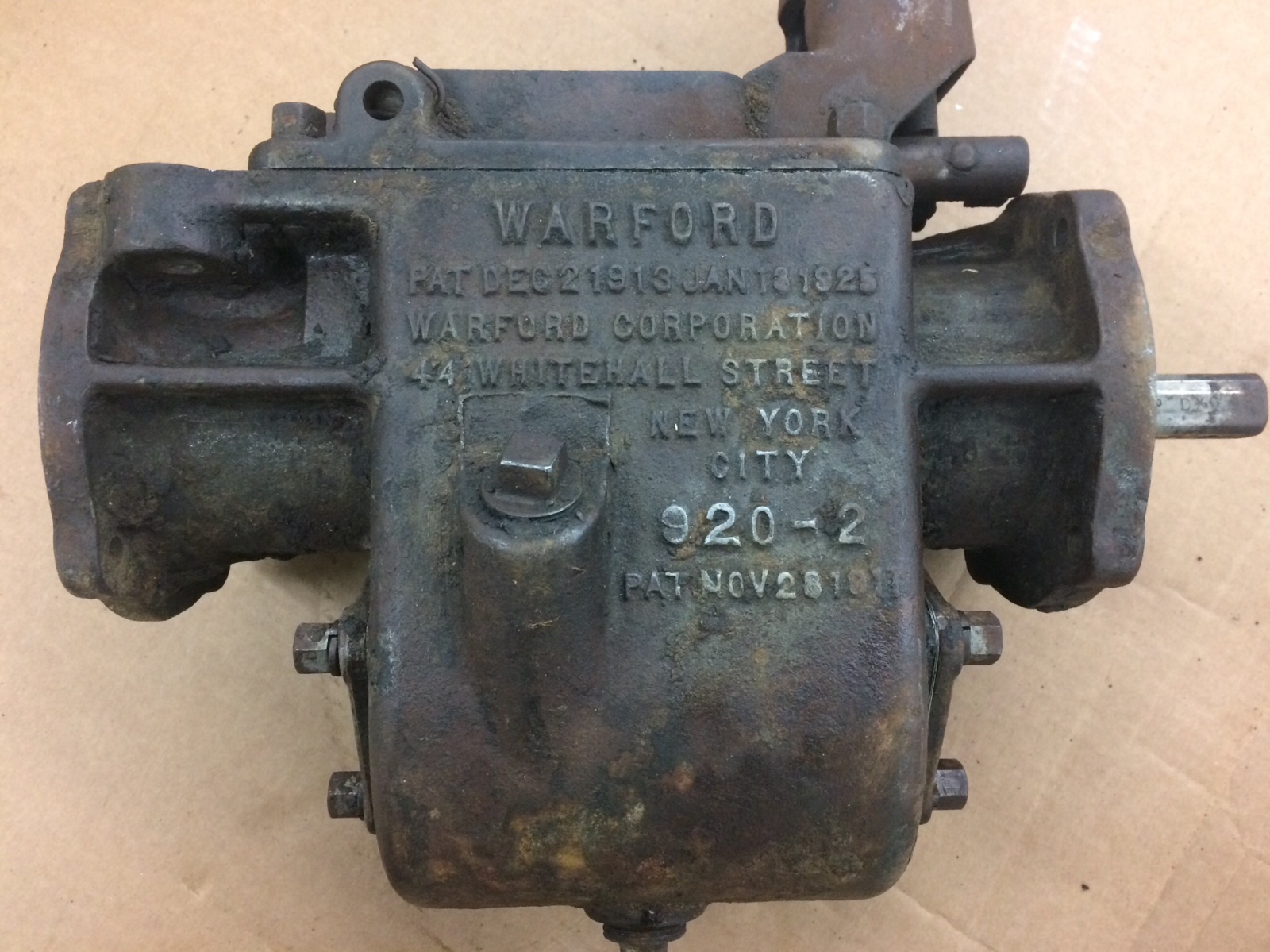

Tim,
This is cast iron #128405B. The shifter base has then number 141170 on it. I need to get more photos of both sides for you next time that I am in the shop.
Matt

Re: Rebuilding Cast Iron Warford
Gene,
Thanks sir the info in. I will see what I can do to remove the nut.
Tim,
Here are more photos for your reference.
Matt
Tim,
Matt
