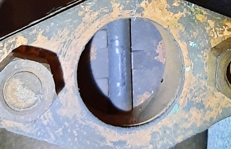

Hi all,
Looking at my Holley NH that I'm restoring, I noticed that the 2 drilled passages at the throttle plate are both showing while the throttle is closed (see pic). Is this normal? Should they both be exposed when the throttle is closed or should the throttle cover the inner one? Thanks.
John

Normal, and important to be in working order.
Holes are noted are for fast idle and slow engine speed D and E.

Here's a somewhat better copy of the service bulletin drawing.
It shows one hole (E) inside the closed throttle and one outside (D), so your situation is not normal according to the drawing.

John,
In your picture, for some reason the throttle butterfly is not closed all the way, you can see a small gap between the edge of the butterfly and the bore. It may be caused by either your idle adjustment screw or the butterfly isn't aligned properly. But the answer to your question is yes, when it is closed only one should be visible.

When the idle adjustment screw is adjusted for this opening, it is usually due to the idle passage being either restricted or blocked. If the carb must be adjusted to run at idle as in the picture. then this is the case

 Showing with butterfly closed tight, only the one passage is exposed.
Showing slightly open like in your picture

Thank you so much Bill,
That hits it on the head. The adjusting screw was in too far. When I backed it out, the butterfly closed completely. Problem solved.
