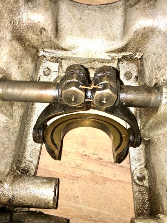

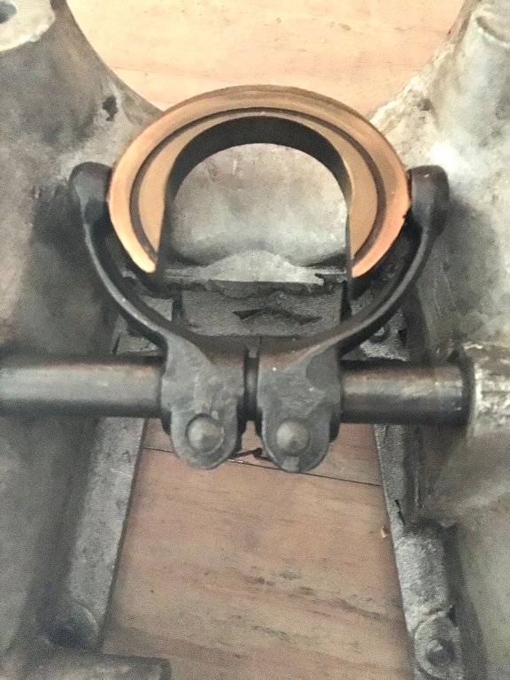

I'm a little late to the party, however here are pics showing the high speed shaft and yoke assembly on my 1911-12 hogshead. Note the brass yoke has on oil groove - at least that's what I'm guessing it is.

Post by VowellArt » Tue Jan 26, 2021 6:53 pm
Rich, ahhh that's what that is an oil groove. I thought it was some sort of plating on the bronze bearing...ok, makes more sense than plating a bronze bearing with babbit.
Ok, I'll make that look more like a groove than a flash coating, thanks Rich!
