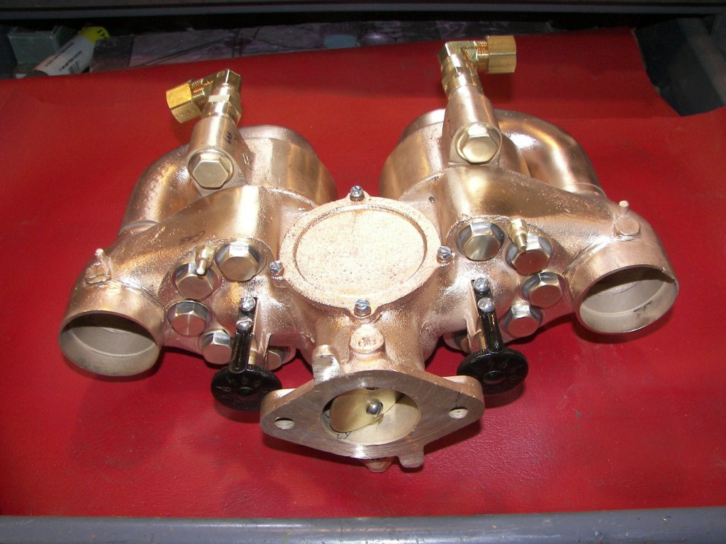

Been working on this for several days. Laid in the mud in Minnesota for probably 50 years or more. It is for a mid teens Avery tractor. Dual fuel. Kerosene or tractor fuel on one side, gasoline on the other for starting. Been beat on with every pipe wrench, rock, pliers, hammer, etc., The balls were rusted into the seats, missing several parts, caps all ruined and had to make new ones, etc., etc.
This is what takes the time.

Note that this is a Kingston ten ball, most of them did not have a tag on this saying Kingston so I did not add one to this. It weighs about 12 pounds complete.

Somewhere I might have a photo of what it looked like when I took it out of the box three years ago. It took me that long to find a correct inlet for the Kerosene side.

Chris, yes, this the last thing they need to get it running after a 6 or 7 year restoration of the tractor.

I couldn't find one of it before I pressure washed the mud off so maybe this is the first one I took. I dunno. It's hundreds of carburetors ago and I am more forgetful all the time.

Nothing. If the owner wants to do something it's up to them.
