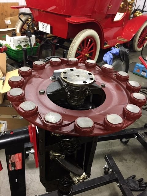

Re: Mag coil experts
Hi There, here the Magneto restoration R.V. Anderson did for me. My 1914 speedster is really please with it. Well done

Mario
That coil certainly looks similar to the one I have.
