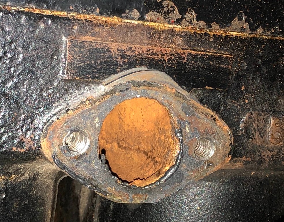

Here are a couple of pictures showing the area now the inlet casting has been removed to drain the flush out of the cooling system. This time the flash was used.

Post by Kerry » Thu Feb 11, 2021 4:10 pm
I'm still saying the pad has been filed. :D

Post by Hudson29 » Thu Feb 11, 2021 4:33 pm
Its sure possible but if so the filer was careful to do the job evenly. There are certainly scratches.

Re: Another Block with No Serial?
Post by J1MGOLDEN » Thu Feb 11, 2021 6:48 pm
The first photo convinced me the area had been ground down to a thinner level.
Most blocks I have ever seen have the water inlet and serial number area ground to the same level.
I always suspected that was here the molten iron was poured in the mold and it had to be cut and polished after the block cooled.
