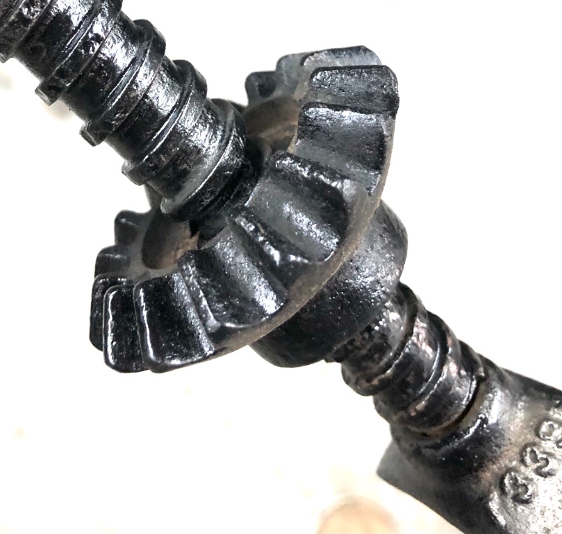

That gear is sized and same tooth count as Ford screw jack, could be from one of those?

Hey Dan. I think you are right. I will check tomorrow against one of the jacks that I have. Makes sense with the spiral groove in the center.

You're right RajoRacer. The gear is a perfect match for the one on my jack. By the way the jack I have is from Auto Specialties and has the name CANUCK on it. Is it probably a Canadian only jack?

David, the ton truck jack is a heavier beast all over. While similar to the Auto Specialties car jack, it would be at least twice the weight and it has a guide/support as an integral part of the casting. This guide acts as a steady for the rising column. Many of these are broken off. The column of the jack has an inbuilt step for the front axle, and the full height of the jack suits the back axle.
The flip top is available on the car weight jacks, but going on the numbers I have ever encountered, there are far fewer of these.
I looked in the 1915 and 1919 Australian spare parts books, but neither shows the jack, so I have no handle on the dates of introduction/manufacture.
Re repairs to these cast jacks, if the base plate is bent, heat must be used when straightening it. Otherwise it will snap off. All the weight of the car is borne by the top of the column/turning gear. This needs to be built up/spaced to reset the gear mesh. If the square thread on the rising column or its drive gear is shot, the jack is probably no repairable.

Allan, thanks for your usual knowledge and insight. I took a closer look at both jacks today and it appears that the "flip-top" jack that I have is not the heavy version used for TTs. Both jacks are about the same weight and similar structure. The handles on both have "Auto Specialties Mfg. Co." on one side and "USA & Canada SJ11" on the other so both use the same handle. The main casting on the "flip top" is marked "RJ87" while the casting of the other jack is marked "SJ10" and "CANUCK". The top saddle on the regular jack is marked "SJ14". The base on the "flip-top" is bent so I will take your advice and heat it before straightening it. This jack has obviously seen some heavy use as the top portion is not level where it is peened onto the screw and I think would easily allow a car to slip off it if used. I will remove the top and attempt to repair the damage. Probably neither jack will see much use but would be neat items to display with the car at shows. I know that any reference material that I have shows the lighter pressed steel jack as stock for all Ts so these ones must be aftermarket/accessory items and may be universal for most makes of cars. Have you ever seen any indication that these were supplied with Model T's? Thanks again for your interest. By the way, I am still looking for one of the rim spreaders for the Canadian made Kelsey rims with the holes in them.
