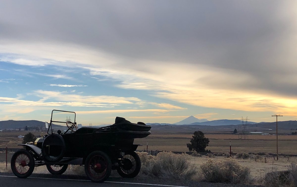

The pictures were taken a few weeks ago on another one of these rural roads.
