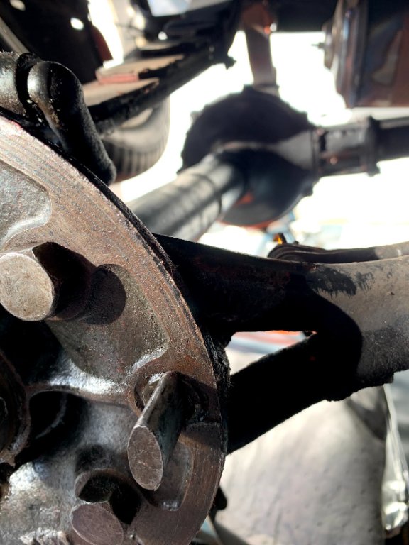

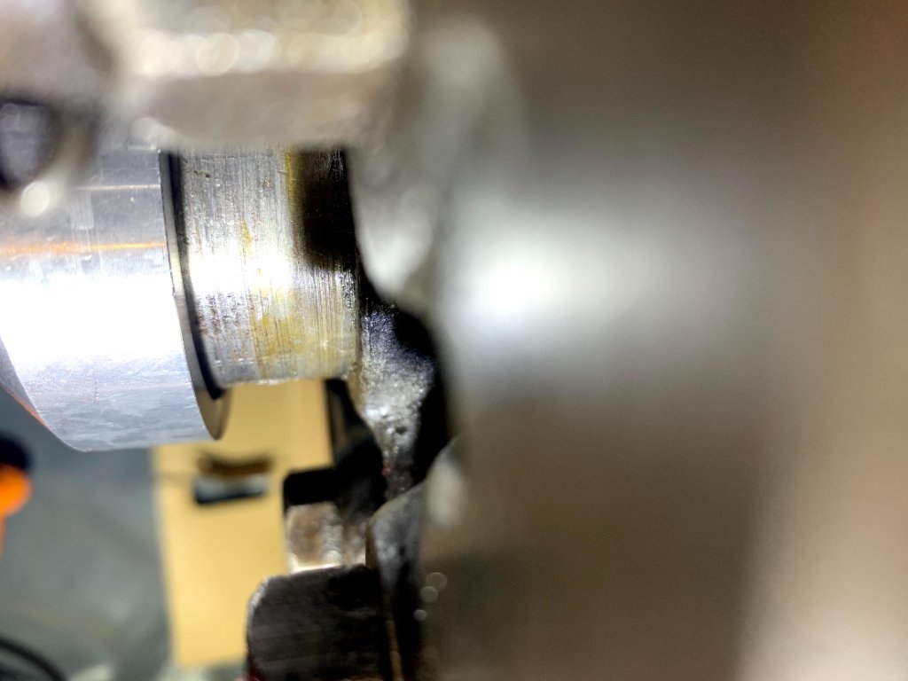

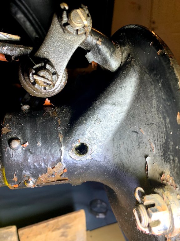

Welp, my suspicion proved to be correct. My outer bearing seal has failed, and my emergency brake is now covered in grease. As imagined, this is notably impacting braking performance. (i.e. it doesn't do sh*t). I understand I'll need to at a minimum replace the grease seal, and probably the shoes and maybe even the cams, but I have some questions that I'd love input on. Namely:
-What solvent should I used to clean up the drum / hub assembly?
-What else should I be looking for now that I have everything apart?
-What torque should I tighten the rear axle nut down to once I reassemble it all?
Also, I'm fairly sure this is my own fault. When I inherited the car it came with grease fittings where there would normally be grease cups. Not knowing how much grease to add, I kept just pumping away with the grease gun, expecting grease would begin backing up at the fitting once it was full. Well, now I know where all that grease was going...I think. Should I be concerned about the integrity of the inner seals as well? Also, how much grease should I actually be adding to the rear for its regularly scheduled lube job?

Besides seals and cleaning, soak the shoes in lacquer thinner to clean lining. They are parking brakes not stopping brakes anyway. Worst case, install new lining.

You have another issue other than over greasing, your axle already has a shim on it and the hub is still rubbing on the seal casing so fitting a modern seal is going to be a problem. Usually it's the hub that has the most wear so find a better hub or remove the hub from the wheel and have the lip turned off. Another option is clean it all and fit the original felt seal that is missing (same as front wheel bearing seal) in the hub/brake drum, new shim and don't over grease the bearing in the future.

Thanks all for the replies. A lot of very helpful information.
I think I'm going to:
Degrease and clean up everything with Brakleen as others have suggested (obviously be careful not to blast it into the inside of the axle shaft)
Replace both races
Replace the inner and outer seals on both sides with new neoprene seals
Clean and repack the outer bearings with new grease.
Order a few shims of both sides to ensure I have a good solid mating between the axle and the hub. (I really don't think this is too much of an issue. I had to really fight to get the wheel off. The key appears to be in good shape too, suggesting not a lot of play)
One thing I've noticed is there appeared to be an almost calk-like substance in and around the existing outer seal. I'm wondering if my grandfather went an extra mile trying to ensure it was well sealed.
I've posted some additional photos, including some photos of the removed bearing. I was planning to just pack it and reuse it, but if you guys can think of any reasons why I might not want to do that, I'd love to hear.

Daniel, regarding shims, by all means have some available. However, they should be of different thicknesses, and you should only fit ONE. Mutiple shims will allow movement betwen them, causing wear to the axle keyway, the key and the hub. The fewer interfaces between components, the better the taper fit is. Ideally NO shims is best. After that, one, of adequate thickness, is acceptable. Before you reassemble the wheel to the axle polish the axle taper with emery tape to make sure all is clean.

I see:
an axle sleeve sticking out like there is an inner neoprene seal already
grease on the shoes
a shim necessary to shim drum out past the extended sleeve
I do not see:
oil from the differential
an external felt on the drum (outside of the metal cup)...these are missing in 99% of cases and that means you are missing 50% of your grease retention ability
I would:
modify the race to sit more like originally intended in the axle
Install ALL of the external seals as was designed by FORD
Install a single shim of sufficient thickness to allow things to fit as necessary (you may no longer need the shim with the sleeve sitting where it belongs)
drive and enjoy the car

The other day I worked on a 1920 Touring car that had 5/16" holes drilled in the bottom of the axle tube inboard of the outer bearing to let out any gear oil that made it that far, has anyone seen that before?? Yes, I have.

OKAY. Both assemblies are apart and cleaned up.
2 Questions:
1) My roller bearings look good, but are only measuring 0.49" each (pretty much universally). I know the manual says the spec is 0.500", but doesn't really say what they start out at. Normally I'm one to err on the side of caution and just swap em out, but it doesn't seem like any of the parts retailers are selling grooved roller bearings anymore, just slightly inferior ungrooved ones. It doesn't feel like there is any directional play, but I don't have the tools to know better.
2) Brake Cams. I'm replacing the shoes with new 1 piece lined shoes from Lang's, and noticed the kit comes with new cams and bushings (but not levers). Given that this project is already late and over budget, I don't love the idea of drilling out the existing cam rivets and replacing them with new ones. (I honestly have no idea how I would rivet a new one in place). Here are some photos of what I'm working with. What do you think?
2 Questions:

Daniel, I think you can buy just the pair of shoes without the cams if your budget is really tight. But, one of your cams is already fitted with a shim, so it is best to replace them at that stage.
First step is to drill the old rivets. Don't drill all the way through. Stop about 3/4 of the way so that you leave a hole to take a pin punch, the bottom of the hole being the point for the punch to push on. The old bushes are easier to extract if you carefully cut them all the way though with a hacksaw so they will collapse. New ones can be fitted by using a length of all thread as a puller, rather than hammering them in. Re-riveting is easier as a two man job. Order new rivets, perhaps an extra one or two as insurance against beginners inexperience. The second pair of hands is needed to hold a heavy buck against one end of the rivet while you pound on the other.
Hope this helps.
Hope this helps.

New seals and bearing sleeves are in, and it appears I'm going to have to modify the sleeves to accommodate the width of the inner seals so they don't stick out. Any tips on the best way to go about doing this? Is this something I should see about taking to a machine shop for, or can it be accomplished with an angle grinder?

I use the inner seals from Chaffins. They have a relief at the edge to accommodate the sleeve. I have not had to grind anything off the sleeve. Sometime the rivets keep the seal from going all the way in and you have to grind or file a little off the rivet head. Seal Manufactured by others may not have the relief.

I would use the 049 in. Hyatt roller bearings. You will probably have .010 in clearance when using new sleeves. I will probably get beat up for saying this, but I have some experience with these.

So it turns out the inner seals were not neoprene seals, but either a felt material or possibly one of the later model leather seals. Either way, the new neoprene seals are in, as are the bearing sleeves. The sleeves still stick out ever so slightly, but I'm hesitant to do anything about it since both the grease hole and the alignment bump are lining up directly on the money. I repacked the existing bearings and put on the new outer grease seals, but I was a little put off by how loosely they fit on the exterior of the axle housing. They slipped right on, and required no tools or force to get on. They also will slide right off, which is what concerns me. I know the wheel hub will prevent them from actually coming off, but I am concerned that the high tolerance between the outer flange of the seal and the axle housing will allow grease to escape, recreating the problem I'm trying to solve. I know when my grandfather restored this car (1922 Center Door), he had to acquire a new rear end because the existing one was shot. Now I'm wondering if the rear end he ended up with was one off of an early model year car with a smaller axle housing diameter. HMMMMM.

I would give them a try. They do not have to be a tight fit, just enough for the o-rings to keep the grease in. Remember not to put extra grease in the rear bearings with the grease cup, and if you want to check to see how well they are working to take off the LEFT wheel first. The LEFT wheel is the one that usually leaks. All you waste is a cotter pin. You should plan on repacking the front and rear bearings every year.

Daniel, 3 tips at no cost, so value them as you see fit.
That much sleeve protrusion is not usual. An angle grinder ill get rid of it. Stuff the axle tube, sans bearing, with rags to prevent grindings getting in, and put some kind of sleeve over the axle as insurance against slip-ups, and have at it.
I make my on shims from steel cans, food grade, paint grade, any container that will give you the clearance you need. Just use ONE which ill get the hub far enough out that you can still comfortably fit the split pin. Re-tension the axle nut a couple of time until the bits get to know each other.
The inside bore of the axle tubes varies somewhat,so it would not surprise me if the same applied to the outside. Fit the new seals with a liberal coat of RTV sealant, which will help seal and retain the cups too.
Hope this helps.
Allan from down under
Hope this helps.
