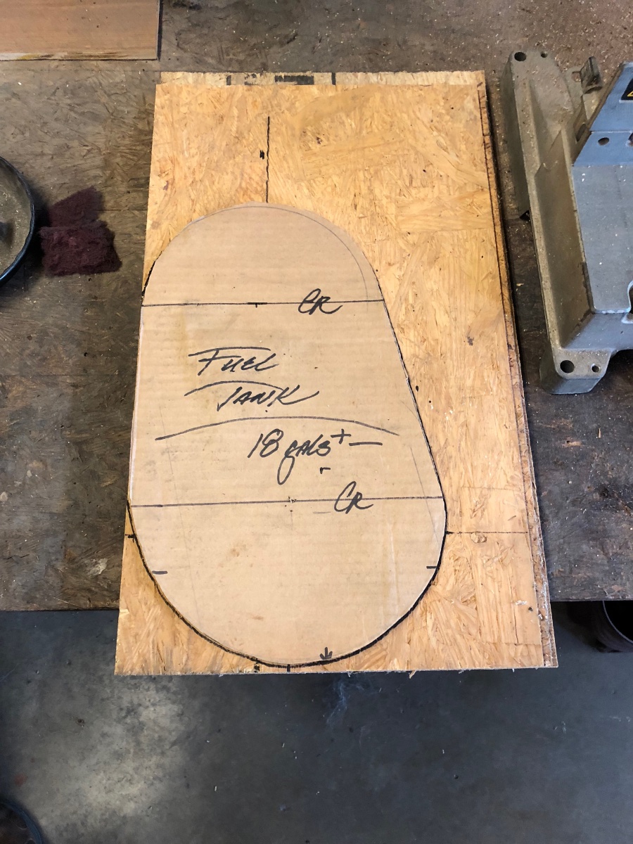

This is the pattern we decided to fit the custom Speedster.
A double lay out and cut using 3/4" Advantech flooring works great.
Cutting as twins and sanding as they are screwed together.[
attachment=1]IMG_1012.jpg[/attachment]
Ready to cut the sheetmetal.
