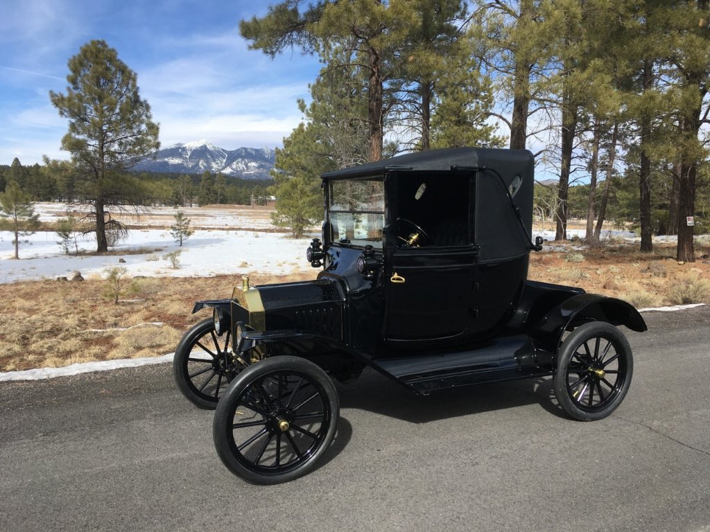

Thanks to the Covid pandemic, I completed the restoration of my 1916 Coupelet in record time.  I've spent the past year finishing off teh car, and now it is ready to drive and enjoy.  I purchased the car from Mike Walker following the MTFCI Boone, MO tour.  Mike had worked on the car, but decided to sell the car when he could not get the body woodworking done in a timely manner.  I took the body to Ray Wells, who did a very nice job completing the wood in the original body, and then took the engine to Jim Blair of Tucson for rebuilding.  The engine was cast on 12-28-15.  As the engine was being rebuilt, I restored the rear axle, front axle and transmission.  When Wells completed the body, I took the body to my Friend Mark Stevens, who massaged the body panels and laid down a beautiful coat of Limco Urethane "Ultra Black" paint.  Following the paint work, Ernie Romero upholstered the seat and side panels, and then installed the beautiful top.
After picking up the body,and painting the chassis, I invited my family to come over and "unite" the body with the chassis. I then painted the fenders, splash shields, running boards and hood. I found a NOS set of Universal "smooth" tires which set the car off very well. The fenders and lights were installed and the car was nearly completed. It was finally time to start the car, so my wife towed me around our one mile loop in our F-250 to loosen up the engine and drive train (I remove the spark plugs when I do this.). When I installed the spark plugs, the car started immediately on magneto!!!
All was WELL! The car drives very well, and while I probably won't drive the car on the dirt roads around Flagstaff, it will be taken on tours and outings.

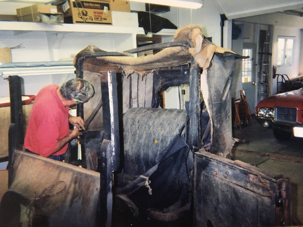

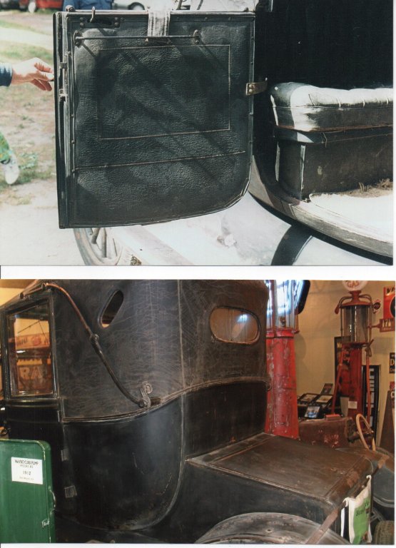

Here is what it looked like before the restoration!!  It needed a bit of work, but it was all there and ORIGINAL!!

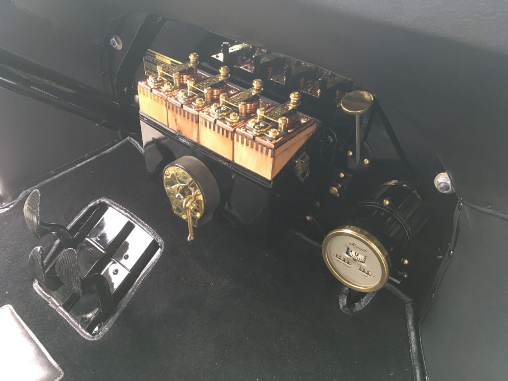

What a jewel!  Russ, could you comment on the finishes in the engine compartment?  It looks like the block, head, and all the fasteners are unpainted.  Is that the way they came ex factory, and did you apply anything to keep the appearance fresh?  Hats off to you, Bill

Bill, The engine block and head were painted with a low-gloss black engine paint from O'Reileys.  The engine pans were painted gloss black and the transmission cover is natural aluminum.

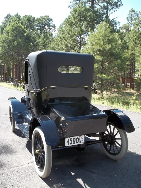

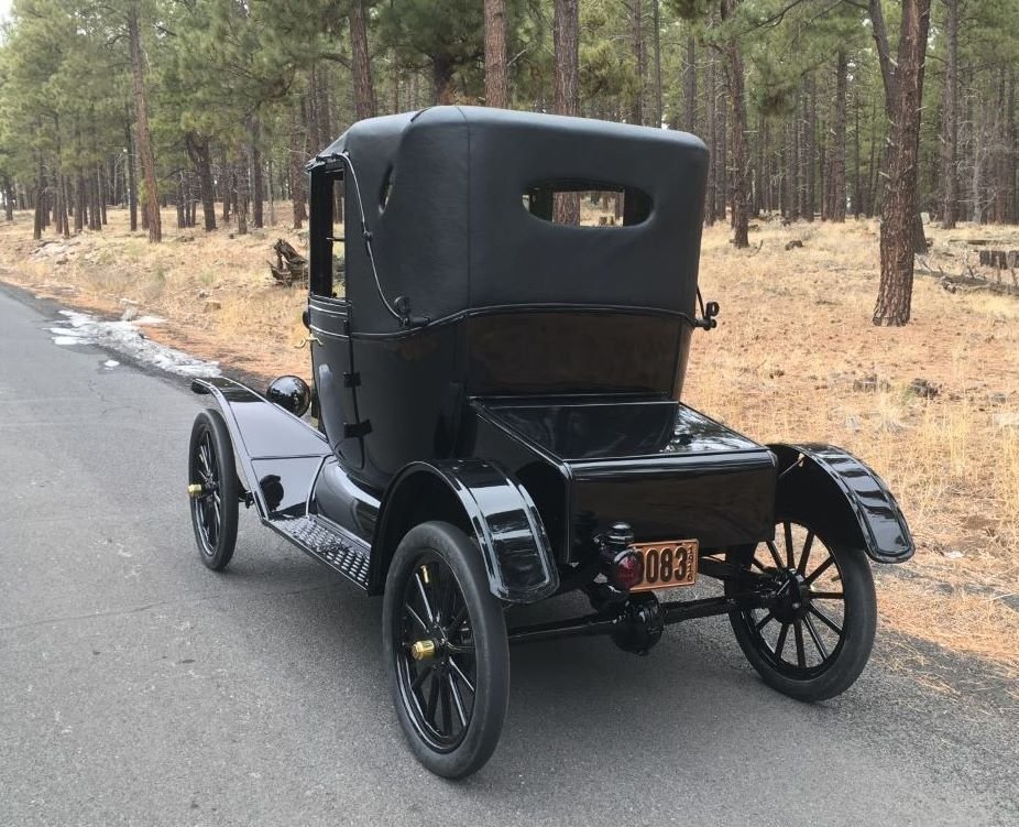

Thanks for the additional pictures for comparison. does the 1916 feature the same brass mouldings around the body and are just painted black or was the external brass discontinued for the 16' model year. the 16 looks much more plain with the absence of the brass, however, it is still beautiful.

Warwick,
The brass top molding on the 1915 is not present on the 1916. The 1916 has a special leatherette "welting" that is unique. The 1916 is definitely understated when sitting next to the 1915, as there is not nearly the same amount of "fancy" brass trim on the car. As for usefulness, the 1916 is a much better car, with its oval opera windows on the top, the deck lid on the top of the trunk instead of the rear trunk door on the 1915, the electric magneto horn and the leatherette top rather than the leather top on the 1915. The 1916 sold better too since the price was dropped to $595 rather than $750 for the 1915.
Both cars are a unique part of Model T history.

There were different manufacturers of the coupelet body, and it is clear that different trim was used on the top. Check out this photo of an original top that is in excellent condition that uses the leatherette trim.  I know the brass trim was used up through mid 1917 since my 1917 coupelet has the brass trim.
