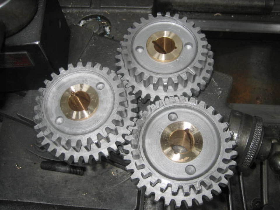

J&M Machine just sent some more pictures of the gears getting done.

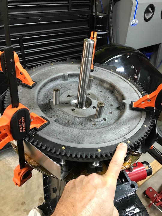

Post by Mopar_man » Thu Mar 26, 2020 10:16 pm
Well today J&M Machine sent me some pictures of the balancing process. John told me that this was not done by the factory but will sure make a big difference in keeping the "Rattles" out of it. Ha!! What a neat process and John and Michael are great to deal with. Unfortunately for me Most everything In my transmission was cracked or broken. I have seen first hand how the cost of doing it right can add up. I'm ok with that. This car is defiantly not an investment it's for the family to have fun and I plan on keeping it for a long time. If I learned anything it's that the Model T has to have everything working together. If not you run the risk of things "coming from together".
So let's get to the eye candy.
The pins pressed into the flywheel.
Magnets going on.
on the balance machine. I couldn't get the stats to post but the flywheel was off. John said that's why it's so important to balance it. After you take all the magnets off and on and get it all together it's off.
Removing some material.
Mopar_man
After it was done the whole thing was surfaced so when I set the gap it will easer.

So I'm going to quote from John at J&M. "I balanced the triple gears today as tat is part of the flywheel balancing. They need to be weight matched. Have a look at the pictures off at 4 grams. After a spin in the lathe I have them at 3 tenths of a gram."

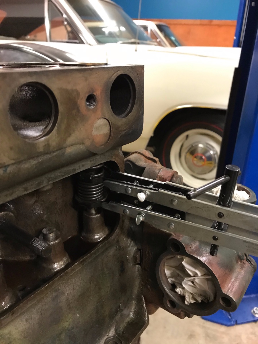

Well today I took out the valves I was able to use a Brigs and Stratton valve spring compressor. Most came right out but some had some sticky oil. I was able to pull them out with my hands. I numbered them 1-8 and then put each in a plastic bag that was numbered. I'm going to clean them up and then lap them in.
https://www.youtube.com/watch?v=De-e_6LKYBw
Then I found my first repair.
Also looks like the cover was not centered on the CAM shaft.

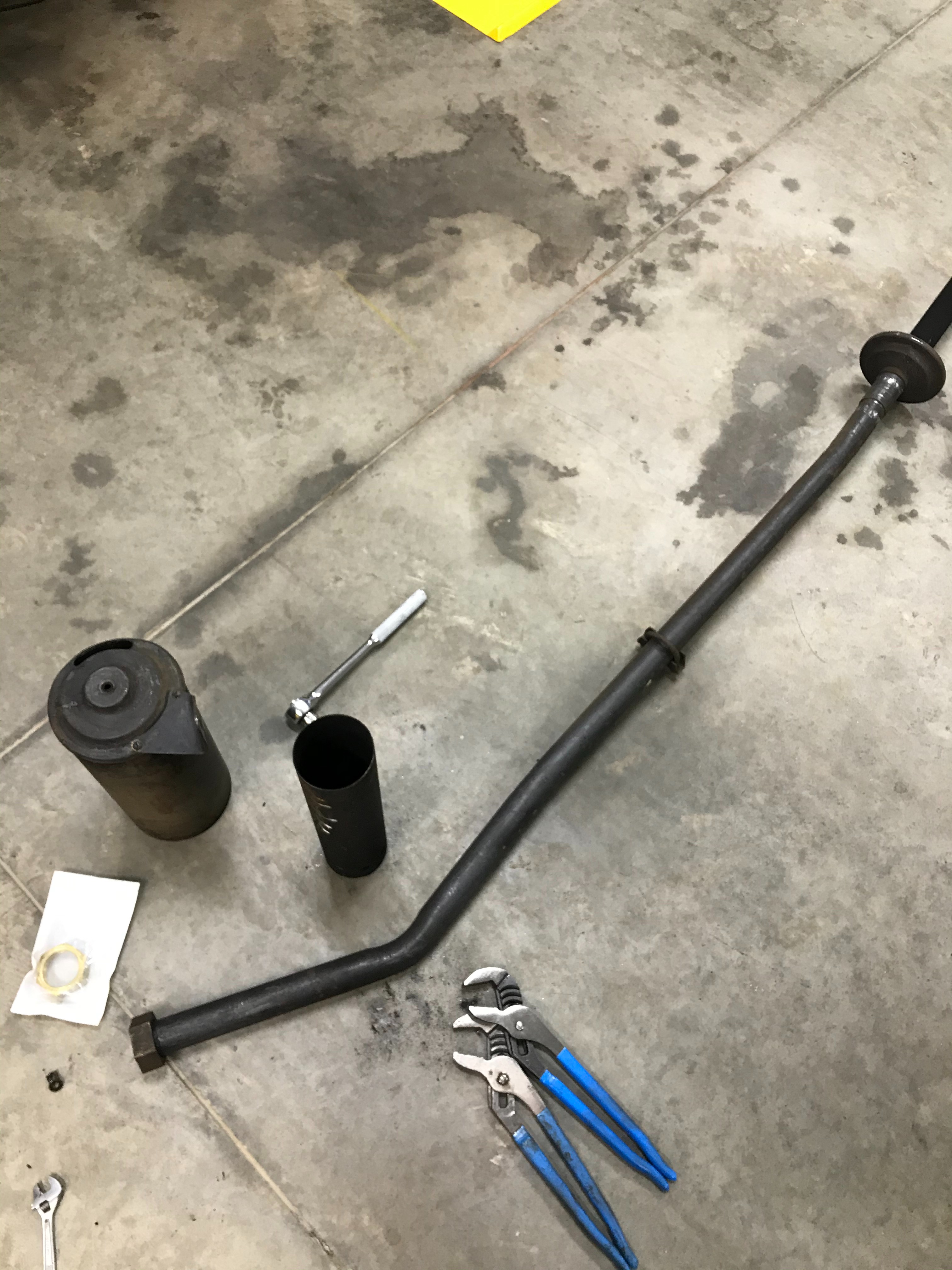

Post by Mopar_man » Sun Apr 12, 2020 6:54 pm

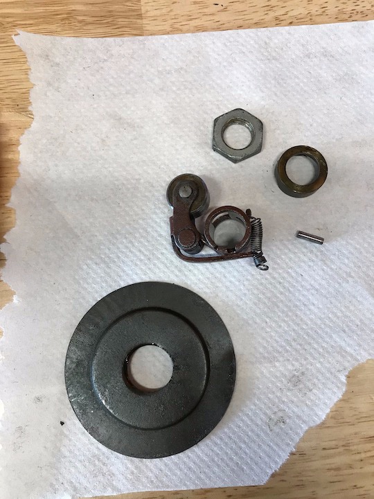

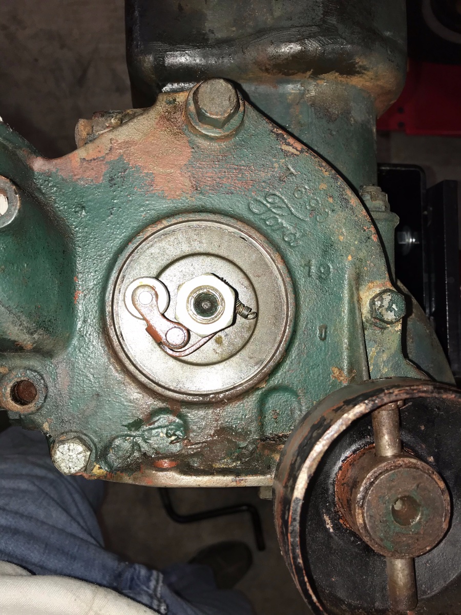

So tonight I tried to get the CAM out. I posted about that in another thread. So here is what I did today.
First I pulled off the roller and saved all this in a plastic bag.
Next the felt washer came out. I'm going to use a neoprene one.
To get the cam out first the cover had to come off. You can see the repair on the cover. Not sure if this is JB Weld or brazed.
The generator bracket after painting.

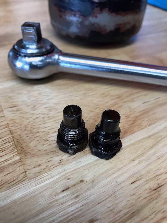

To take out the CAM you have to remove these two bolts.

Well tonight I got the CAM Shaft out and the new CAM gear on.

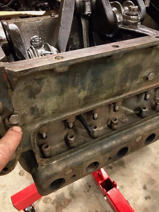

I'm not sure this CAM bearing was in correct. The notch was not towards the back of the motor when installed. So the top part of this picture was facing the back of the motor.
Looking at this part of the valve seat it looks like it has hardened seats installed.

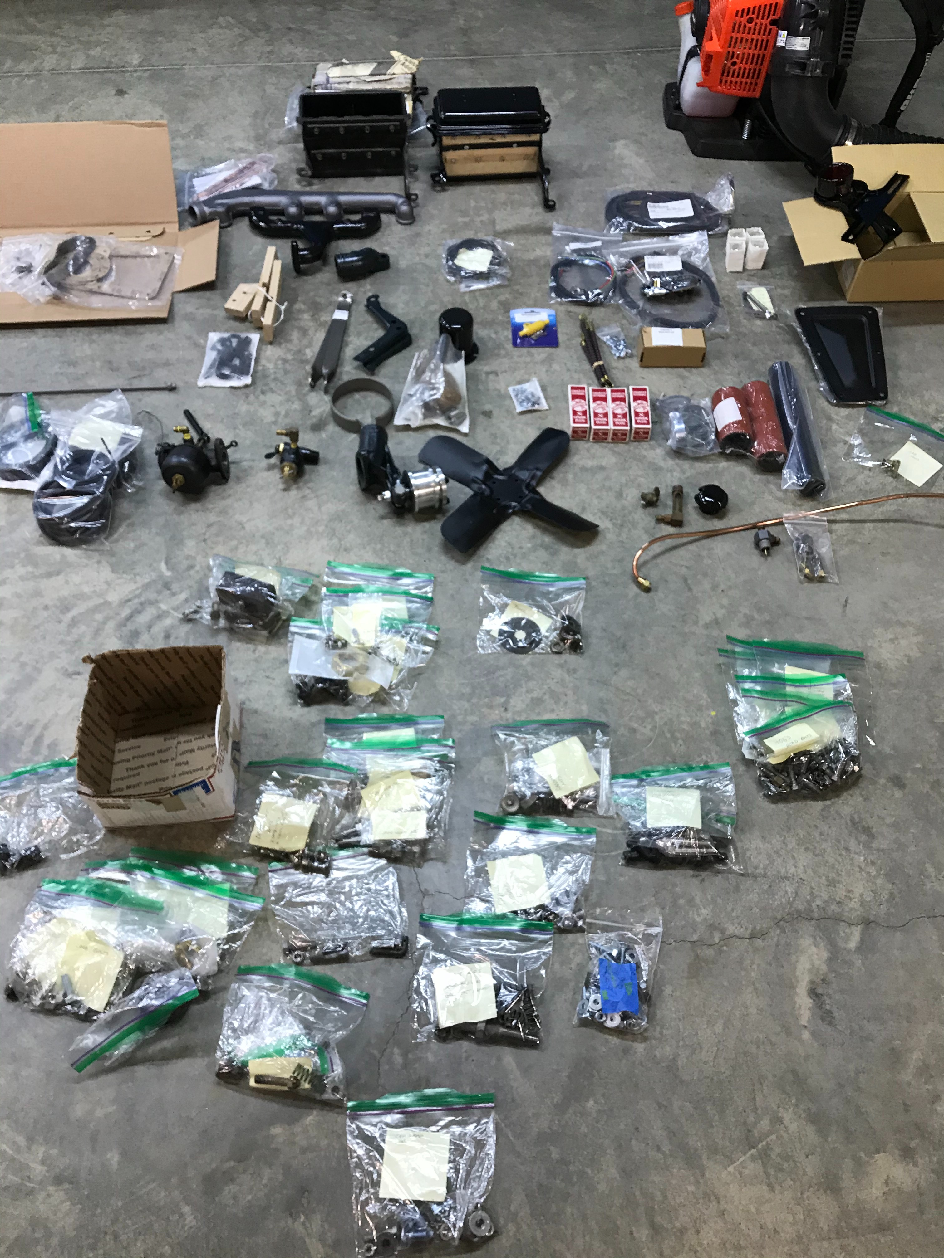

Post by Mopar_man » Thu Apr 23, 2020 10:09 pm
So today I received my transmission in the mail. I opened up the boxes and It was like Christmas morning. The guys at J&M Machine did a great job and I can't say enough great things about them.

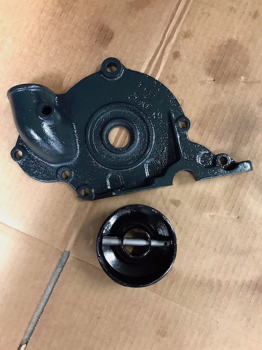

I also painted the Timing cover and Crank pulley.
I was also able to fit the center bearing on the cam shaft and get it to slide into the block. I thought I was going to have an issue with it but it went in just fine.

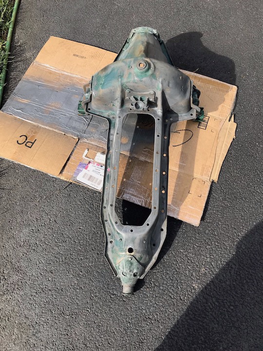

Post by Mopar_man » Sun May 03, 2020 9:33 pm
Well It's been a while since I've been able to get out to the garage. Today I got the Cam Shaft in.
For those who have never had a Cam Shaft out of a T before these two blots have a dowel end and hold two Cam Shaft bearings in place. The end of the shaft is supported by the block.

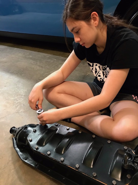

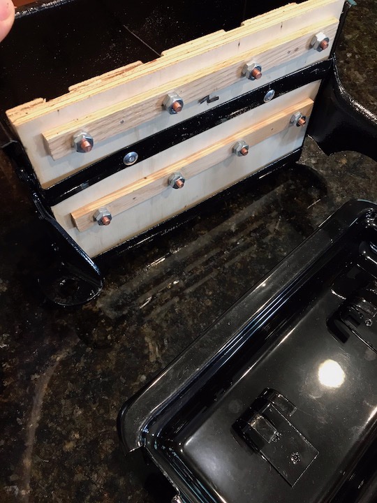

So now that I have adjustable lifters I have to grind off about 1/16th of an inch of the valve stem. You can see how much it sticks out of the seat. The cam lobe is on the low side and the adjustment is run down but also allowing for some adjustment.
I also got some cleaning done on the pan. I ran this part through the blaster.

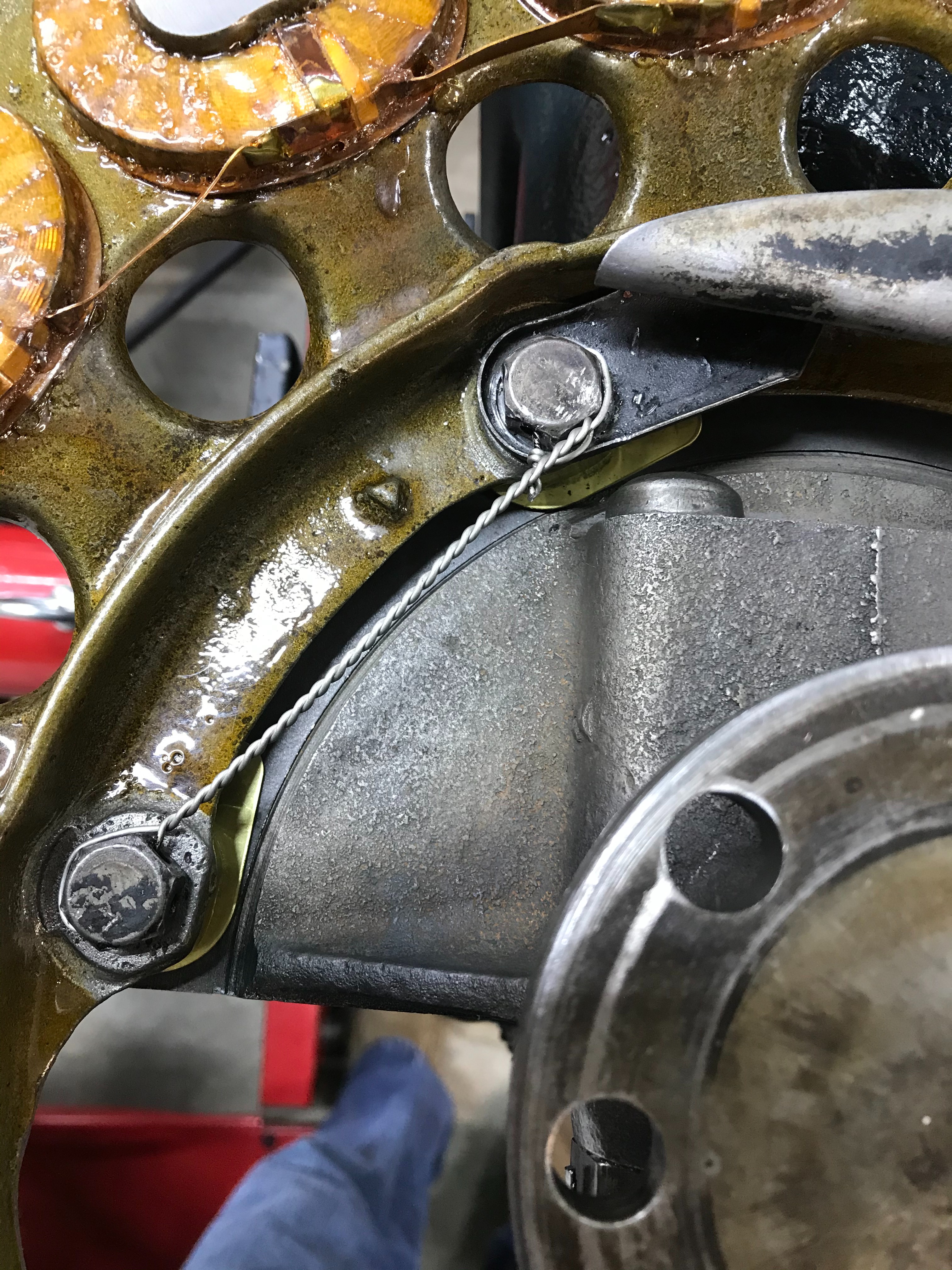

Post by Mopar_man » Sun May 10, 2020 4:02 pm
So today I was able to put the timing cover on as well as the generator bracket. I hope I did it correctly. Here is how it went.
https://www.youtube.com/watch?v=HZOtiRKoP9M
The tool made it seem easy to align the cover.
I used the new kind of seal. It fit well but I added a layer of sealant. I'm letting it dry for 24 hours.

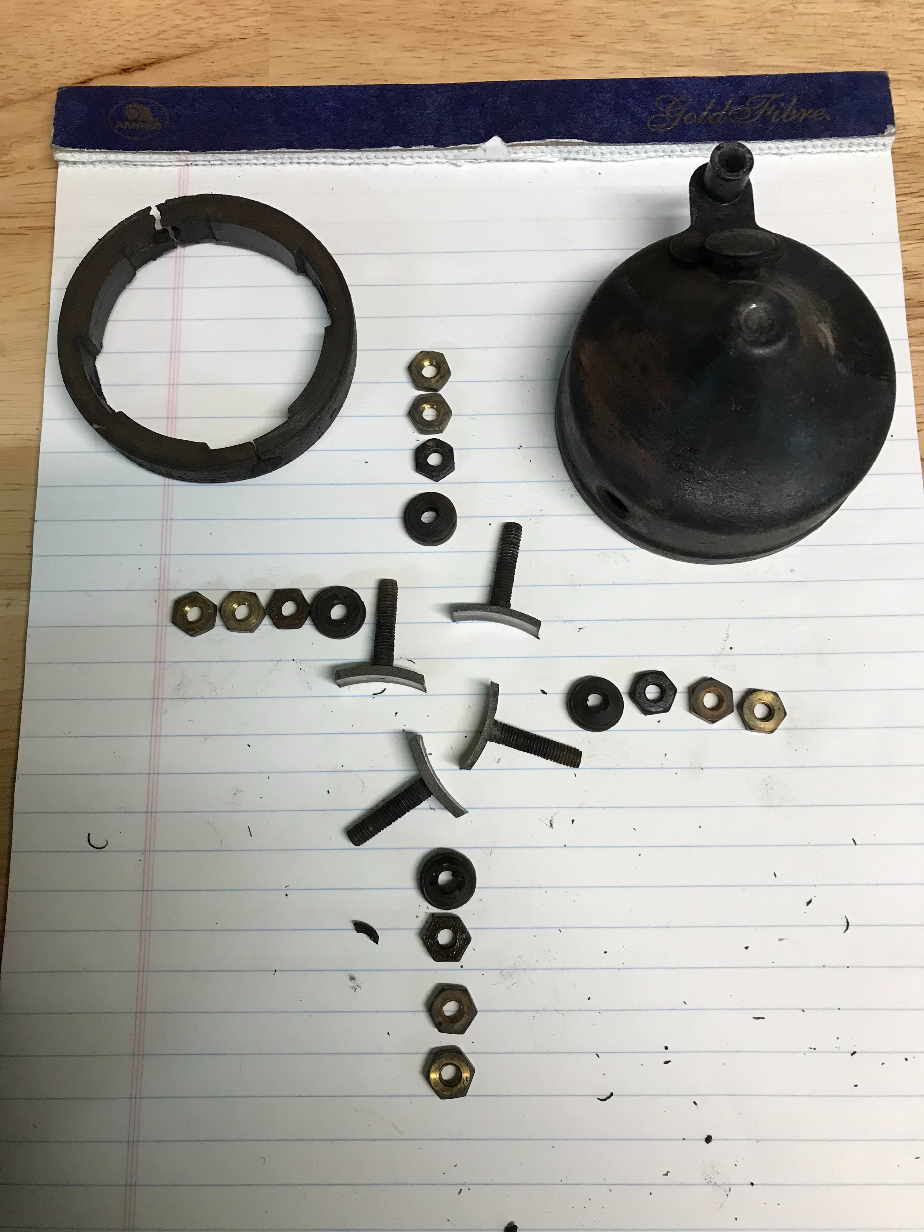

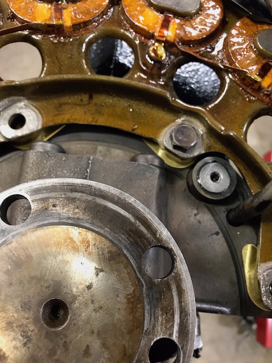

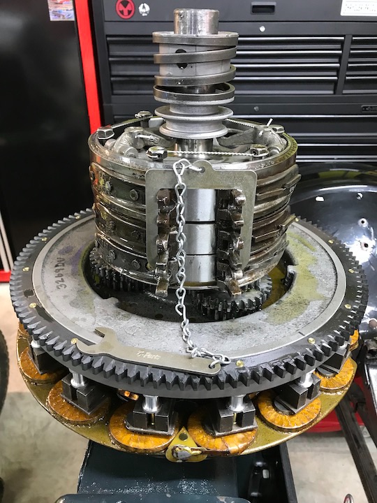

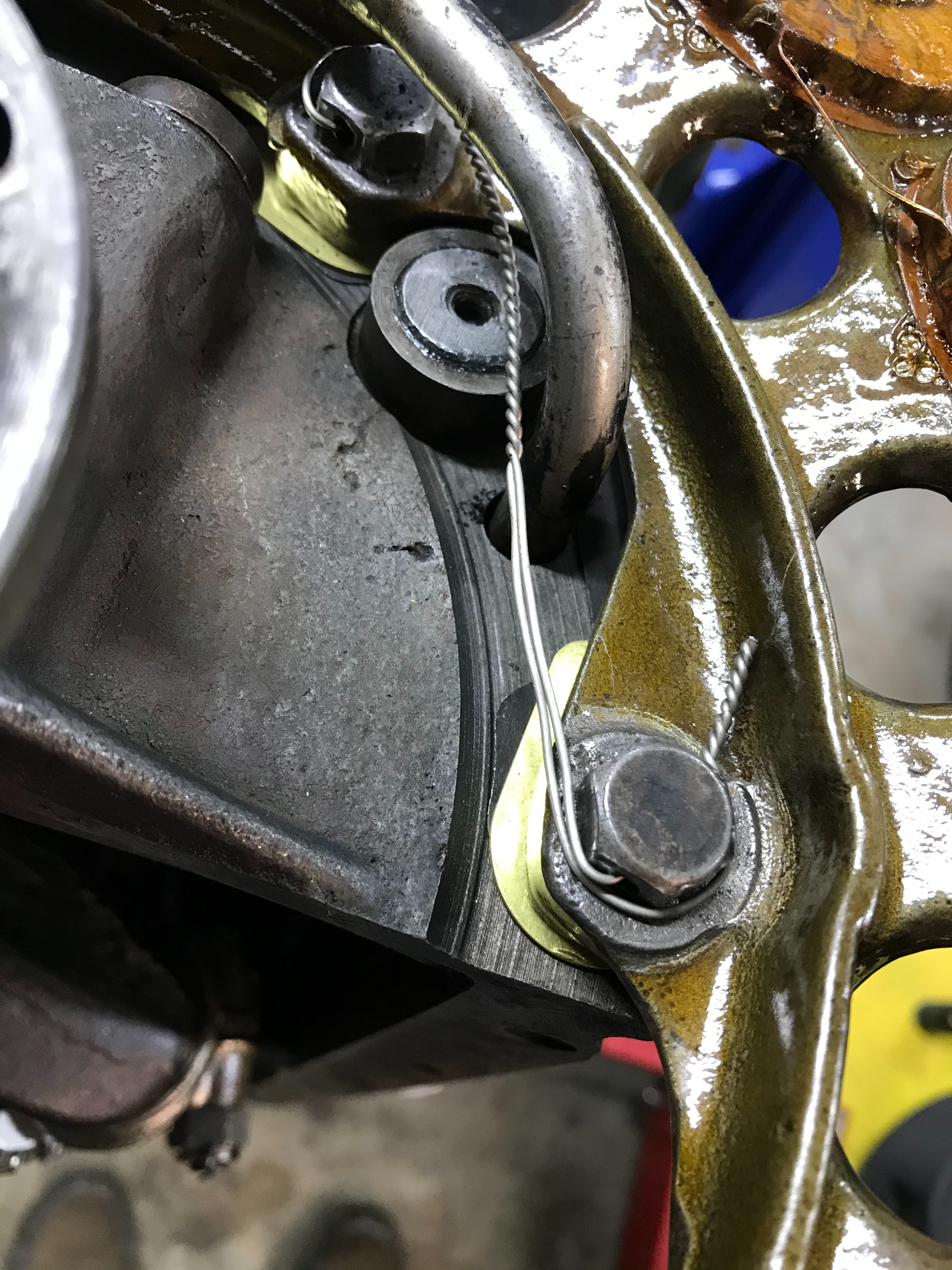

Then I moved to fiting the shaft to the flywheel. Michael from J&M said that the new shaft may not fit into the flywheel hole. It seemed to go right in with no issue.
Now will come the fun part of shimming the Mag ring. I'm going to try the method that was described in the MTFCA Magazine.

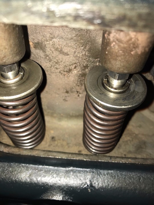

Post by Mopar_man » Thu May 14, 2020 10:25 pm

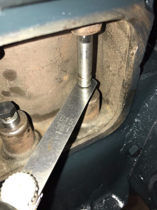

So tonight after work (I still work for the Marine Corps, now as a civilian. Grateful that I can work from home) I started putting the valves together. Big thanks to John and Mike at J&M Machine. I sent the valves out to have a bit taken off the ends so they would fit with adjustable lifters. They turned them out in a day. I can't sing their praises enough. If you have machine work to do have them do it. You won't be sorry.
So first I made sure that the cam was on the back of the lobe. Then I got the gap adjusted to .015.
Then I put a bit of assembly lube on the valve stem and put the spring in with the keepers. When I see a Model T spring compressor I'm buying it. The small one I'm using is a bit awkward.
Then I turned the engine over and gave it a bit of a tap with a hammer to make sure that everything stayed together.
Still have a few more to go. Slow and steady is i don't make mistakes. I hope.

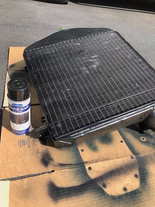

Today I cleaned up the pan.
I was able to get it in the blast cabinet.
Then I flushed the radiator. I had posted about that in another thread.
I also took out the car and cleaned up a lot of the dirt and junk that was all over the firewall. As I was doing all this the mailman came with my valves from Lang's. He asked to take a look at the cars and really liked the T.

So today I took apart the cam shaft So I could fit the new valves. I know I did a good job sealing up the Cam shaft cover since I had to tap a razor blade in-between the metal to separate them. I ended up cleaning the cover up in the blast cabinet and repainting it.
I then put the cam back in and dummy me forgot the lifters. So I had to take it all apart again. I also painted the radiator and installed the shroud. I've had good luck with Radiator Black from Eastwood in the past.

Something to consider. I've been using assembly lube on everything. The lifters require something a bit different. This stuff:
Angie used a q-tip and applied it to the lifters and cam lobes.

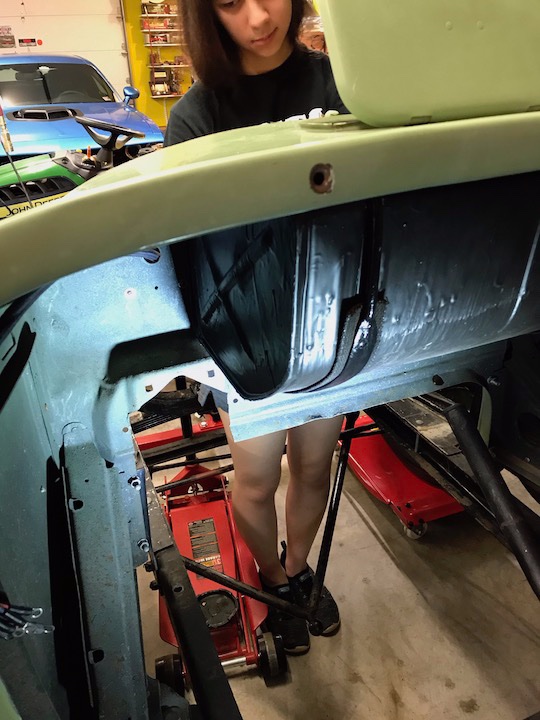

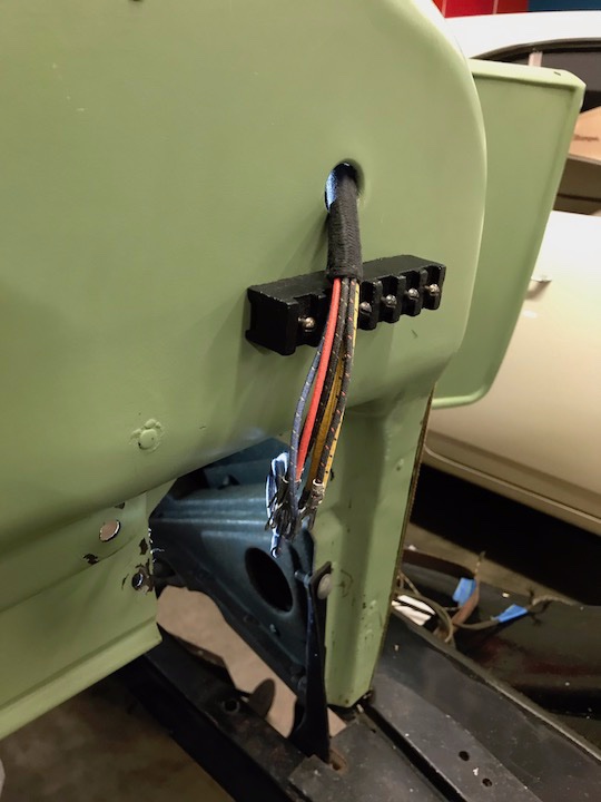

Well yesterday if you saw my other post you saw that I got the oil sump area cleaned on the pan. Today I was able to get the gas tank in.
First I put on the new terminal block and wires.
The tank went in easy without the engine, pedals, dash board, steering column, or interior in the car. I put it in and my daughter in the front to add the washers and nuts.

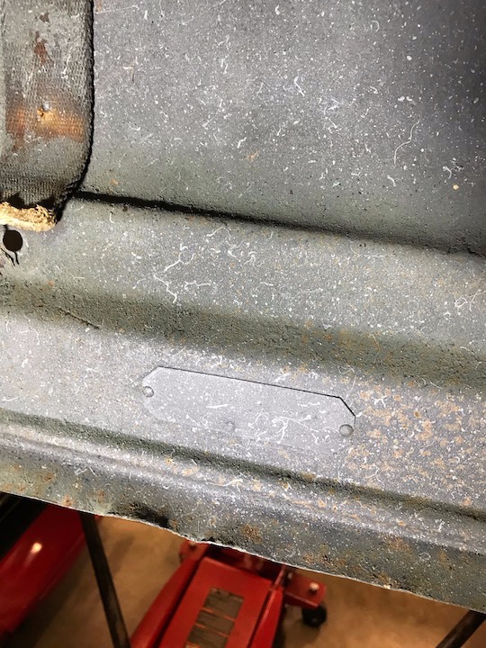

I think this is the data tag that has all the Pat info on it. Looks like it got painted over. Am I right?

I was also able to paint the back of the dash. It had a bit of rust on it and although you will never see it I sanded it and put a coat of paint on it.
Then we put the 4 Dip pan on. I'll paint it once it dries. I can only imagine having to do this with the engine in. How you can catch the threads on the two Horseshoe shaped metal straps that would move around seems to be impossible. You would think Ford would have welded them in place.
Posts: 6523
Re: Getting Rattles Back On The Road
Post by Scott_Conger » Sun Jun 21, 2020 6:44 pm
Robert
you install 3 short pieces of 5/16 all-thread into each horseshoe. You can install the bottom cover with the engine horizontal in the car or vertical on an engine stand. Once a couple cap screws have caught some threads, the all-thread is removed and saved for next time. Makes the job very easy.
Mopar_man
Posts: 1152
Last Name: Govoni
Location: Fredericksburg, VA
Post by Mopar_man » Sun Jun 21, 2020 6:58 pm
Wow I never thought of that. That would work. Brilliant!

Well I finally got around to working on the GAP for the Mag Ring. Most of the day Saturday was spent on getting two of our other cars back on the road. Some Fuel filters got them right and I was able to work on the T. I read the article in the MTFCA Magazine and thought I'd give it a try. This is a video of the first part. I had to use a rubber mallet to get the shaft on the two small pins of the flywheel.
First you have to put the Mag ring on with the bolts real loose. Then install the flywheel and tighten the blots all the way. At this point the Mag Ring will stick to the magnets creating a big gap under it. Take a measurement there and subtract the GAP you want .025 and then shim the rest of the GAP.
We will see how many times I have to do this to get it right. Ha!!!
https://www.youtube.com/watch?v=KZFzOts ... e=youtu.be
Mopar_man
Posts: 1152
Last Name: Govoni
Post by Mopar_man » Mon Jun 29, 2020 9:40 pm
So after work tonight I took some measurements from behind the MAG Ring. I made sure I had the 4 blots tight from the crank to the flywheel. I made a drawing of the measurements then I subtracted the Gap I wanted. I went with .025. I am open to discussion as to how big it should be. I figure .025 would allow the trans to sag a bit and make the Gap on the top a bit bigger. The book says .025 to .040.
Here is what I got with my measurements. Remember The flywheel magnets have been surfaced so my initial Gap was a bit big.
So you can see the size of my shims I need to add. #1= .045, #2= .053, #3= .055, and #4= .055. As John from J&M Machine said "That's a good start." Ha!! I think I'll be taking this off and on a few more times.
Also I hope I didn't make a mistake by installing the valves and head. I've been careful turning the engine over by grabbing the flywheel. I haven't had to force anything so I'm hoping I didn't ruin the valves after all I went through to get them right.
Mopar_man
Posts: 1152
Last Name: Govoni
Post by Mopar_man » Tue Jun 30, 2020 10:11 pm
OK. So tonight I shimmed the Mag ring in accordance with my measurements from yesterday. I was able to cut the shims by heating them up and then splitting them with a razor blade. Yes just like buttered bread when you drop one they land sticky side down.
After I attached the flywheel I took my first measurements with the engine on it's nose. Here is what I got.
I think I'll take away some shims and increase the gap at the top of the mag ring.

Post by Scott_Conger » Tue Jun 30, 2020 10:37 pm
for itteration #2, that's looking darn good...myself, I will never install another mag ring that wasn't surface ground...what a difference in the consistency of your numbers...sweet.
Mopar_man
Posts: 1152
Last Name: Govoni
Post by Mopar_man » Tue Jun 30, 2020 10:59 pm
Thanks Scott. I was wondering if the measurements of .042 would be too much. I'm thinking that when the engine is in in the correct way it will sag a bit and close up the gap a bit.

don't misunderstand...I mean for 2nd shot at it...I'm not saying you're done...you have the book and the numbers...it's up to you to decide when you're done
Mopar_man
Posts: 1152
Last Name: Govoni
Post by Mopar_man » Tue Jun 30, 2020 11:15 pm
Oh I know. I'm going to try to shave a bit more off the shims under the #1 and #2 area and see if I can increase the gap at the top and close it up at the #9 to #13. Sorry had to rethink this and fix my numbers. Ha!! :lol:

Post by Mopar_man » Wed Jul 01, 2020 6:40 pm
OK. I know I need some advice. When I bought my Mag Ring they didn't have any surfaced ones in stock and said the people that do them for Lang's wouldn't have them for a while. I tried to get the gap correct however I have one side that is producing a larger than .040 gap. If I remove some shimming material I'm thinking that that will only make the gap bigger. Or do I have that wrong? I tried adding some to one side but the gap under the shims becomes way too small. Does anyone suffice Mag Rings that I can send this one to? I also nicked the sealant in one area. Is that ok? I know this is a right of passage. :lol: :lol: But could someone chime in and help.
Posts: 6523
Post by Scott_Conger » Wed Jul 01, 2020 7:02 pm
removing .002 from 1 and 3 area will open that gap around the 2:00 area up and SHOULD reduce bottom 8"00 area a little and you would be golden.

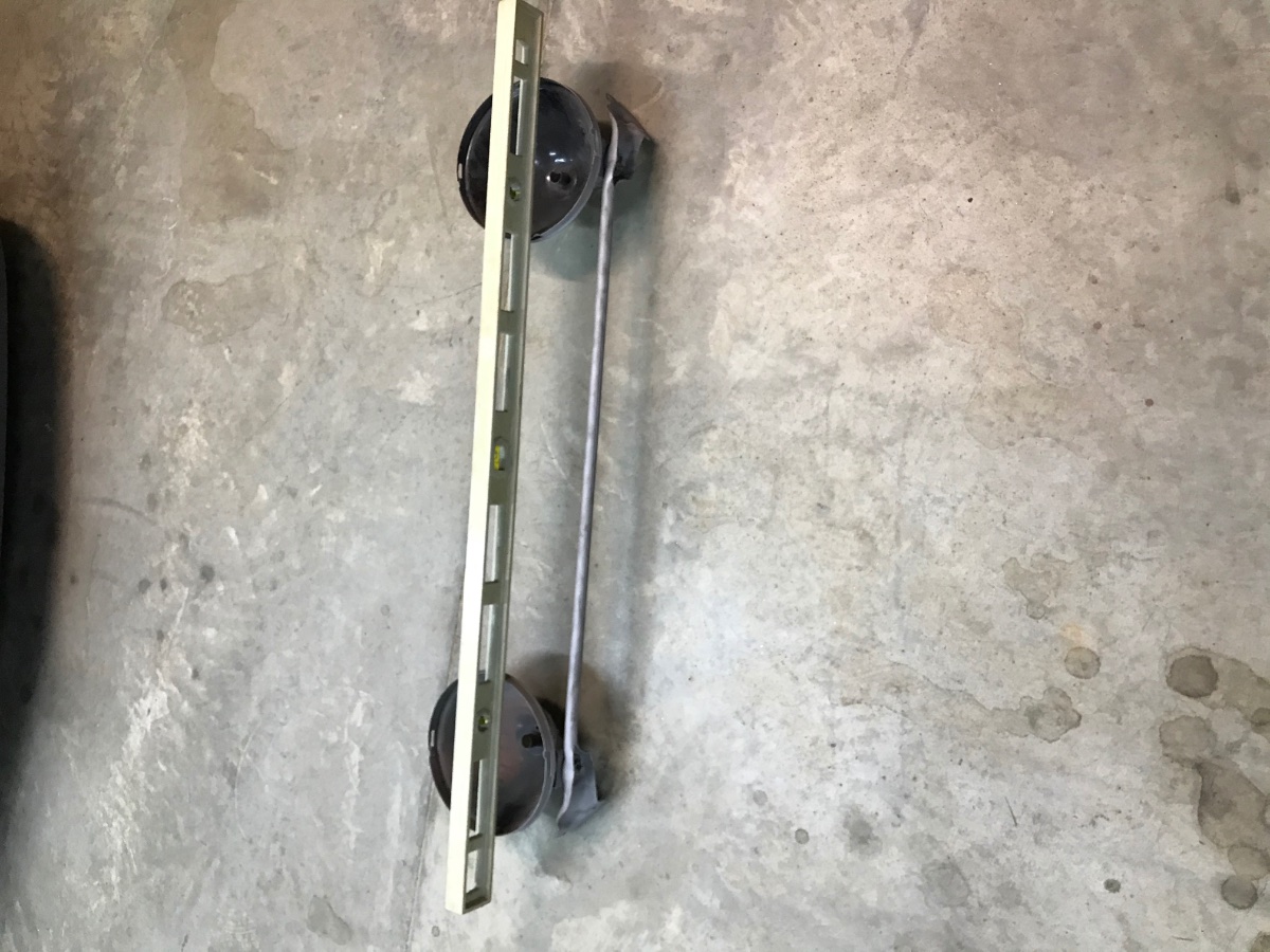

So tonight I was able to clean up the headlight bar. I put a straight edge on it to get me in the ball park of adjusting the headlights.
I always enjoy finding the Ford script on everything.
I also got this apart. Had to cut the nut off. It was so bad it was round.

So today some stuff from Lang’s came in.
I got all the windshield rubber. Ball bearing pulley, fan shaft and nut. 4 headlight bulbs so I have spares, washer felt, in line fuse, 1926 engine support straps (already have the pan brackets.
Also sent my mag ring out to J&M Machine. They were able to true it up for me. So I’m hoping it goes together a bit easier.

Post by Mopar_man » Wed Oct 21, 2020 8:54 pm
Seems like I'm going to have to chuck up the shaft bolt in my drill press and sand it dow a bit to fit. Di you have to do that to yours?

So I decided to put together my water inlet. I posted some separate questions to make sure I'm doing it right. Specifically the washer that comes with the pulley. I think I know where it goes now. Anyway here are some pictures of what I did. A word of caution. I had to put the main bolt in a drill press and sand about 1000th off with 400 and then 600 sandpaper. Then polish it up with 0000 steal wool.
Here is a video I did of how it goes together.
https://www.youtube.com/watch?v=TS0euvUiIHE
You can see here that the bolt doesn't fit the bearing.
Here is the exploded view.

OK I know what you are all thinking. What the heck is this guy doing now. John and Mike from J&M Machine try not to laugh too hard at me.
So let me explain. I'm trying to get rid of any variations that I can.
1st I made a mark on the crank and the flywheel so I know I'm putting it on the same way every time. The pins are going in the same holes. All 4 bolts go on as well to hold the flywheel to the crank and are tightened.
2nd I put an arrow pointing to the magnet that allows me to line it up over the same part of the mag ring.
3rd I got some roofing flashing that is the gap I want the magnets to be from the mag ring.
4th I put the mag ring on loosely and allowed the mag ring to stick to the magnets creating a gap where the bolts are that hold the mag ring on. To make sure that it was even all the way around I clamped it.
Now I just need to measure the gap under the bolts that hold the mag ring on and put the correct shims in.
I know maybe I'm overthinking this.
You want to use non magnetic material for that, such as brass or aluminum.

So tonight I Shimmed the recently surfaced Mag Ring and I think I've got it.
Making sure that they lobes of the shims are not going to get in the way of the felt seal.
Here is a video showing how I bolted it together and how the oil line goes in.
https://www.youtube.com/watch?v=1N5y4unrqKQ
This is how my Gap came out.
https://www.youtube.com/watch?v=DRZdu-u37o8

So tonight I did a bit of organizing of parts. Hope I remember where all this goes.

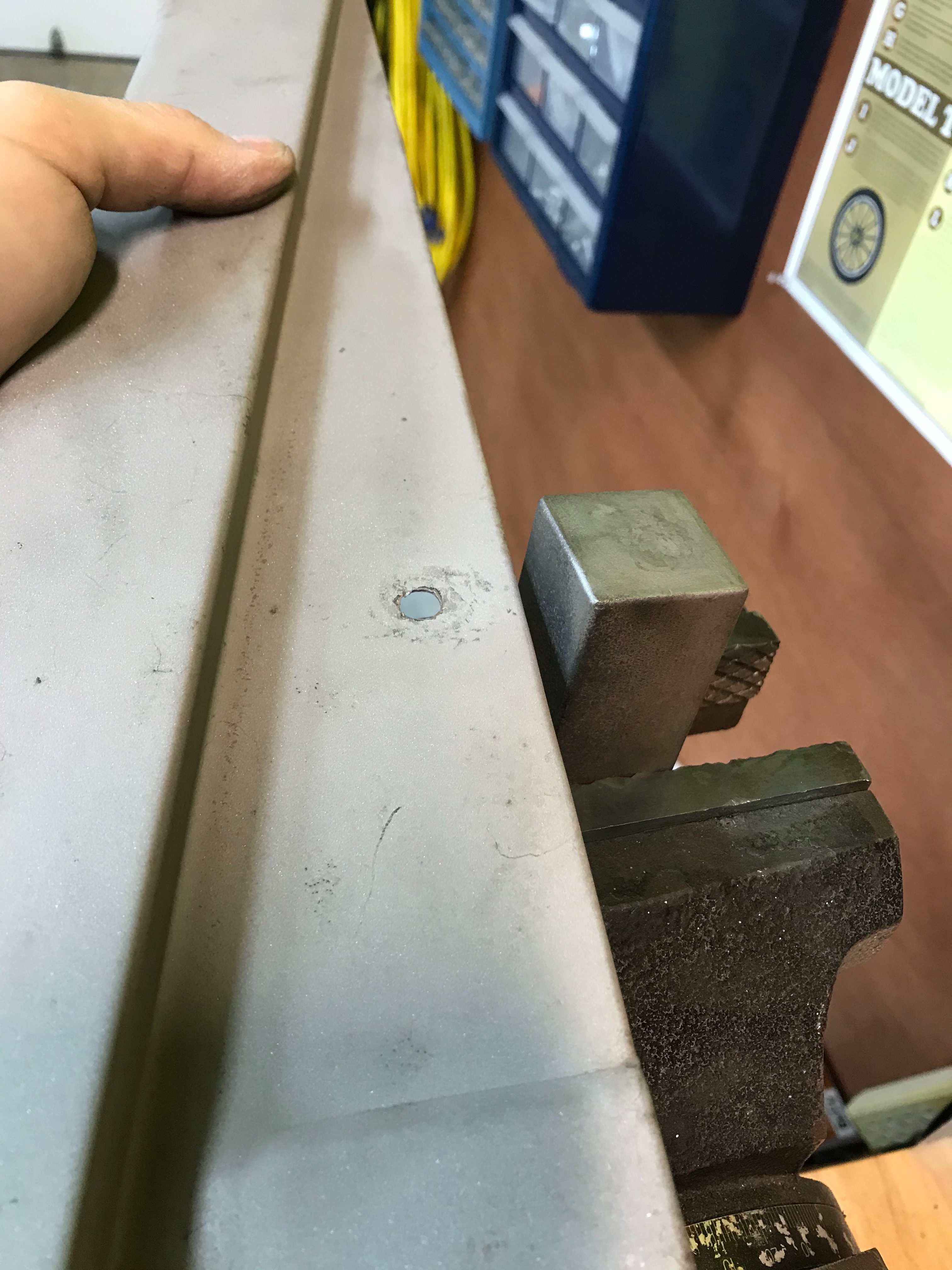

I also took off my hood shelves and cleaned them up. Had to use a dolly and hammer to straighten some of the holes.
Now I need a bit of help. I was able to ID all my parts and labeled everything except these two gaskets. Where do they go?
Posts: 2825
First Name: Dallas
Last Name: Landers
Location: N.E. Indiana
Post by Dallas Landers » Wed Nov 11, 2020 7:27 pm
Top is mag pickup. Still thinking on the lower one
Posts: 2825
First Name: Dallas
Last Name: Landers
Post by Dallas Landers » Wed Nov 11, 2020 7:32 pm
Lower one could be gas cap gasket

Well today I took apart the timer to clean it up. I didn't bead blast the contacts just the body of the timer and the studs and nuts.

So sometimes you have to do a little bit on your T for a "well that looks good" moment. Today I installed the tail light. I know it's an easy thing but it looks good. Ha!!
I also painted these as well as grinder off the markings on the bolts and painted them as well.
This was a big step I know the guys from J&M are saying what the heck is taking him so long!!! So today I also timed the triple gears. I used the U mark and went every 9th tooth.

Tommyleea I just picked it up. It's about 85 pounds. When I was adjusting the gap I only had the flywheel on and off. I have seen some here with chains picking it up. Probably not the safest way to do it.
Harold. Nope like you I haven't had been able to find one that worked easy. I used the Ford type valves. If you use adjustable lifters you will have to have the valve stems ground down. You can't do that so well with the valve retaining keepers. The pin keeper has more stem that you can grind down.
I posted this story in the off topic side before. Angie is my 15 year old daughter. Watch those springs!
So we are putting in the valves on the Model T. The spring compressor kept falling off the spring and I decided to compress the spring with my hands with my arms around Angie's head so she could see where to put the pin in to hold the spring. Then she calmly says: "So what are we going to tell the emergency room Doctor?"
This link has some good info as well.
viewtopic.php?f=2&t=17104&p=129405#p129405

A bit of progress. My first safety wire job. Now for the Flywheel bolts!!

Well I got an e-mail from John at J&M Machine. He looked at my safety wire job and pointed out that the wire should be twisted as close to the bolt as possible. so I took it apart and did it over. I can't say enough about J&M. They are always checking up and making sure that I'm not making mistakes.
So this is what happens when you think that you are just going to do something simple. I thought, Let me put the Pac Nut on the pipe so it will be ready to go the I install the engine. Seemed like an easy job. Then I couldn't take the pipe out of the muffler. So I got under the car and saw that the muffler was all loose and the whole thing had to come out. Then I tried to separate the pipe and couldn't do that. I'm going to have to now move one of my other cars and and put the pipe in the pipe vise to get it apart. Well it least I know how it all goes together.

Today I also safety wired the Flywheel to the crank. I know it's going slow but it will get there.

Here is the setup.
Then I put the key in and made sure it was flat agent the cup.
I also painted the oil pan blots. I forgot to do that the last time.

Well i got the clutches in. I'm using a Jack Rabbit Clutch set. So The first thing I did was soak the clutches in oil for two days then I scuffed up the new large disks. I stacked them as the directions said.
Now I just have to compress the spring and then bolt on the Clutch plate. The directions said that you may have to use another large disk if you have some wear. I'm hoping since everything is new it should be ok.

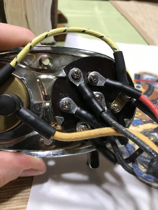

Post by Mopar_man » Thu Feb 04, 2021 7:38 pm
Well tonight we wired up the switch for my 26 touring. I did find the the contacts on the reproduction wiring harness were a bit big. So I used a larger lock washer. How did my daughter do?

So tonight I decided to take apart my steering column. The springs were missing on the adjustment rods. The rivets are missing and the gear cover is stuck.
So then I cleaned up some of the parts with mineral spirits and put them in the blast cabinet.
