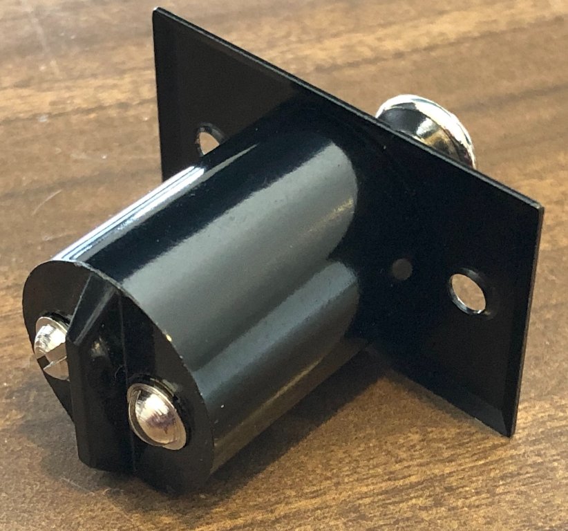

I replaced a headlight switch. I'm no electrical type at all so I consider this a minor victory. My '14 project car had been converted from gas to electric lights. One worked OK, the other was dim sometimes & out other times. As part of my attempts to generally improve the electrics I had removed the coil boxed and cleaned all the contacts inside & out with a wire hand brush & some contact cleaner. The switch was sealed so some of the cleaner was sprayed onto the shaft and worked back & forth.
I didn't see any changes electrically with anything. The motor started and ran about the same. Only when I tried the lights was there a change. Now neither headlight would work at all. I got out the meter and looked to see where there was 6v but could not understand the readings. The switch, the meter or my brain were out of order someplace.
I ordered a magneto headlight switch which I wanted anyway as its a Ford T part only one year more modern that the car. The new switch, of course, would not fit. The barrel was too big to fit in the hole left by the old switch. Time for the Dremel with a sanding drum which quickly made the hole large enough to winkle in the new switch.
There were two holes in the firewall just perfect for the mountings screws No. 5 x 1/2 from Gatelatch. I wonder if this firewall might have had an original magneto headlight switch on it at some time? If so, why was the hole too small?
The wires were reinstalled and the headlights worked just as they had before I "improved" them. A bit of wiggling of the wires at the headlight end revealed that the problem is in the connector someplace. Next session we'll see if the contact can't be improved there.

The new switch is in now and looks pretty good. The only thing that bothers me is the handle. It looks to be chrome plated. Should it be brass or nickel plated?

The first switch shown is a replacement. It only needs the hole large enough for the thread to go through. The ody of the switch then sits in the engine compartment. Your replacement is correct. The hole has to accommodate the switch body.
If you find a piece you know is chromed, hold it up to your new switch pull to compare the two. I think you will find your switch is newly plated nickel.
Chrome has a blue cast, nickel is yellow, a bit like LED lights compared with incandescents.

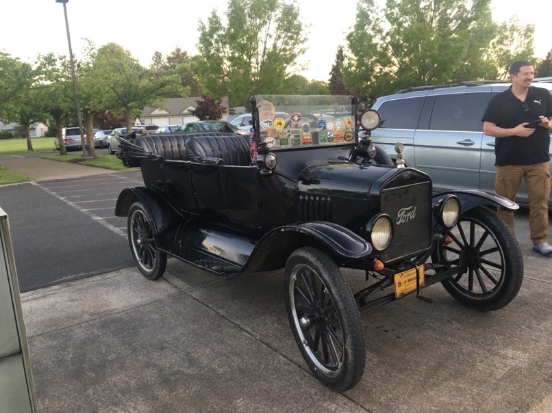

Post by Powerwagonmaniac1 » Sun Mar 07, 2021 12:43 pm
Tin Tillie’s new heart
Clayton and I sent the winter rebuilding an engine and Warford overdive for Tin Tillie our families 1919 touring.
New features include: z head, .325 lift camshaft. .020 over aluminum pistons, modern valves, high flow intake manifold, straight they NH carb, rebuilt transmission and bonded linings, new 4th main, rebuilt the cast iron cased Warford that’s been in her for 40+ years.
Been two years since the old motor died so very much looking forward to
driving her again.

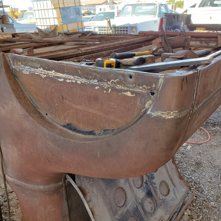

Post by John Warren » Mon Mar 08, 2021 6:31 pm

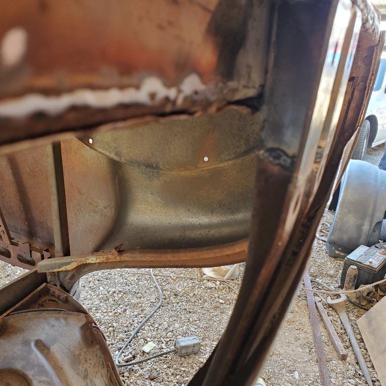

Been doing some repair on the 26 coupe.
Re: What have you done with your Model T in March?
Post by Rich Eagle » Mon Mar 08, 2021 7:09 pm
That's time well spent. Looks like you have the work where it is easy to get at.
John Warren
Posts: 1071
Last Name: Warren
Location: Henderson, Nevada
Post by John Warren » Mon Mar 08, 2021 7:12 pm
It is a very handy position for these repairs, thanks. jw

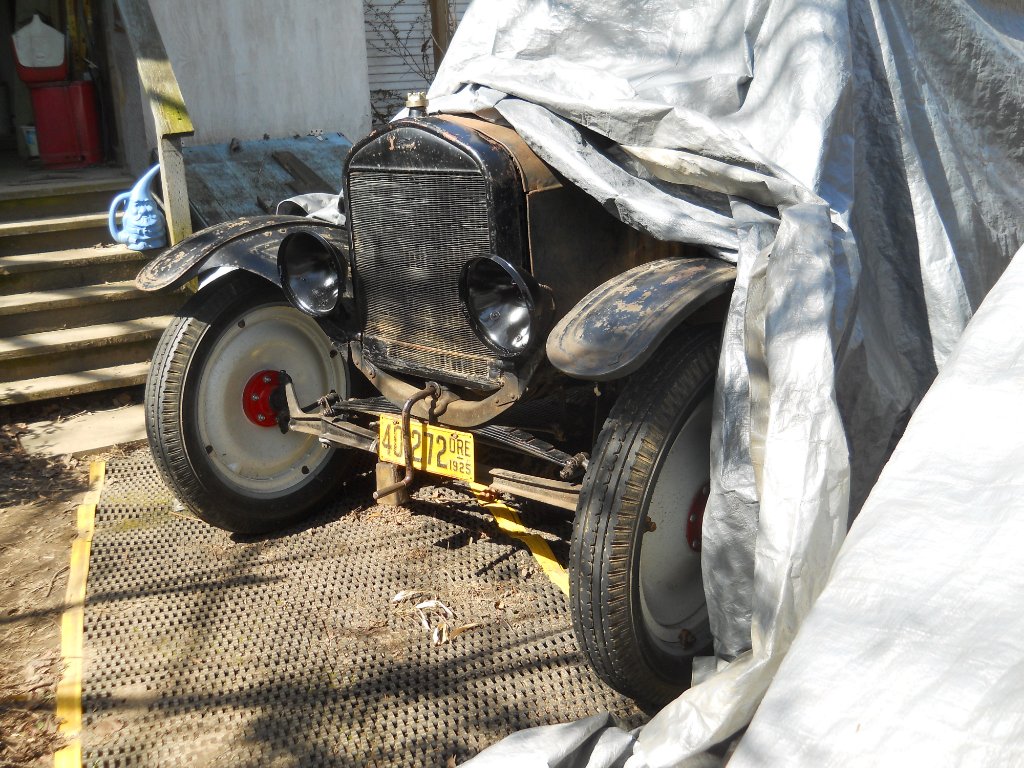

Post by Ruxstel24 » Wed Mar 17, 2021 3:44 pm
Checked the oil and tire pressure, went for a little ride, about 10 miles.
A beautiful sunny 65 degrees and little wind. :D
Rain and cold till the weekend, so today was the day !
Sarikatime
Posts: 713
Last Name: Seress
Location: Prescott, Arizona
Post by Sarikatime » Thu Mar 18, 2021 11:43 am
Dave, does the wind wing help so the air doesn’t come to the back of your head as you drive, the wind coming back around to the back of my head drives me crazy. I see that you have the roll up back curtain, does that help as well. I ordered a new top but no back curtain, is that a mistake. Can still change the order. Frank
Ruxstel24
Posts: 2410
Last Name: Hanlon
Location: NE Ohio
Post by Ruxstel24 » Thu Mar 18, 2021 12:53 pm
Frank, the wings help some, but the roll up curtain REALLY helps.
Not correct for my 24, but Pop added it later after he made the top.
(yes he made tops from scratch, no kit...wish I was better at it) :(
The window really cuts down drag and inherent Model T noises also. (Kinda like turning up the radio :lol: )
And of course adds much more visibility.

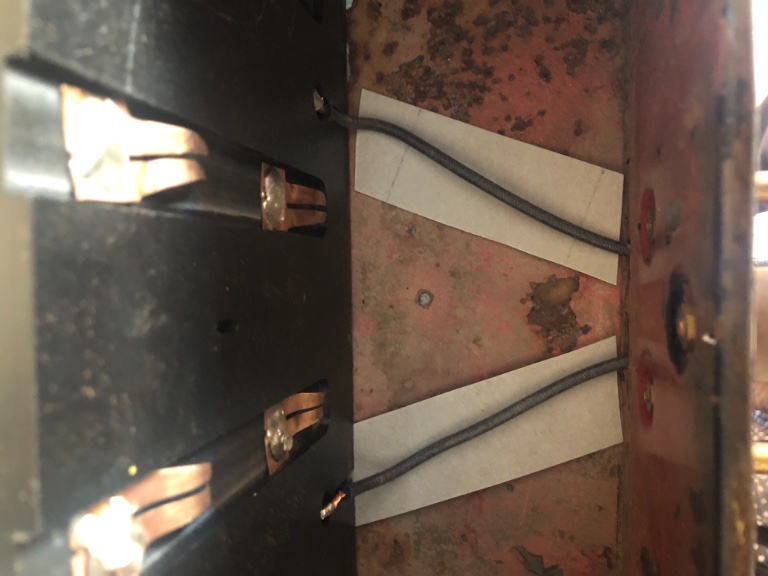

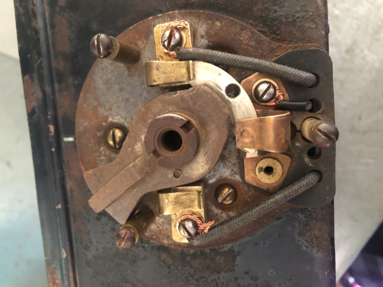

Post by ryanf1023 » Thu Mar 18, 2021 9:12 pm
Finally got back to my coil box after months of it sitting. My soldering is getting better with time and practice. I also put fish paper underneath the wires to prevent any shorts to the box itself.
The battery connection is bothering me. The tight wire connection has the switch rubbing against it. I figure it’s a matter of when, not if it rubs right through the cloth and insulation. Perhaps this one is better soldered. And if that’s the case, might as well do the same to the magneto connection. I can’t really foresee any reason not to, as long as care is taken to keep it contained and away from any insulators.
Next step is weathering the top of the box to match the base of it.

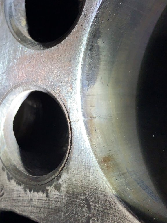

Post by Scott C. » Sat Mar 27, 2021 1:30 am

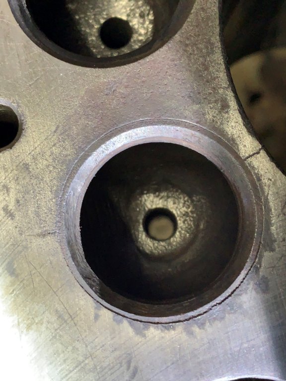

I finally got the engine out of the 26 coupe taken apart. Only to discover that the block is cracked in 3 places!!
AndreFordT
Posts: 565
Joined: Sun Jan 06, 2019 12:25 pm
First Name: Andre
Last Name: Valkenaers
* REQUIRED* Type and Year of Model Ts owned: 1926 ; 1922 ; 1915.
Location: Scherpenheuvel
Post by AndreFordT » Sat Mar 27, 2021 4:06 am
You will need a Lock-N-Stitch and than sleeve the engine.
Seen this before after setting steel valev seets.
Good luck
Andre
Belgium

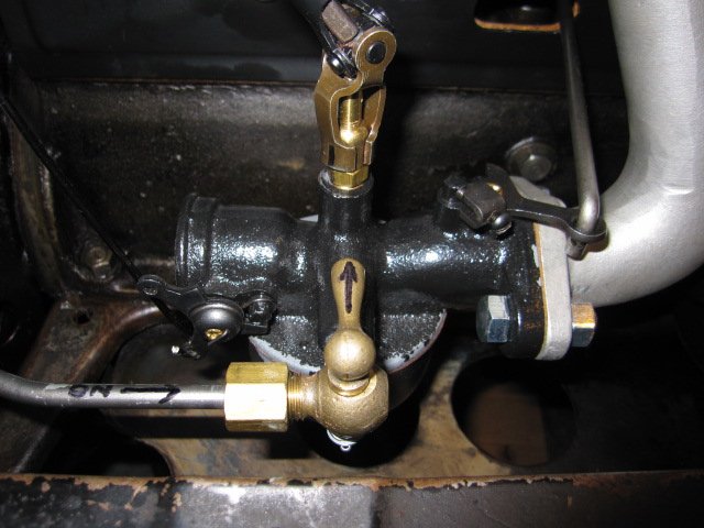

Today I finally got around to fitting the H1 Holley carburetor Uncle Stan rebuilt for me some years ago. The occasional leak of fuel when I turned off the van became more frequent, and I was getting T'd off getting under the car to turn off the tap. I'd bought another tap to fit next to the carby to save having to go down whenever I stopped for long, but if the new one didn't leak, that would not be a problem.
The installation went well, but I had to fit a fibre washer under the fuel bowl nut to cure a leak there. While at it, I replaced Stan's nice new screws with the brass originals from my old carby. The linkage needed shortening to get a lower idle and that just meant a little more bend around the back of the manifold. No leaks as yet, and it is much easier to start. The choke and throttle plate shafts on the old one were well worn, and that problematic original needle and seat is also worn.
I'll still turn it off under the car when I put her away when I get home, but I am looking forward to trouble free motoring for a while now.
