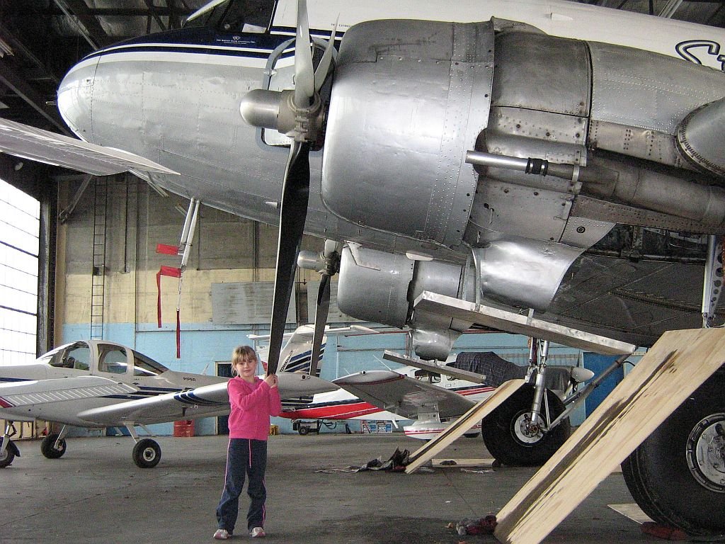

Re: A new tool
Oily radials? Never!
As you'll see below, despite drip trays we had to utilise various methods to reduce the oil flow via motor to the hangar floor from our twin wasps, one of these wash guns would have been a good thing... :

Re: A new tool
Luke, that's a beautiful machine! DC-2 or DC-3?
You are right! Radial aircraft engines don't leak at ALL.
If they are out of oil, of course!

Re: A new tool
C-47, so you were pretty much on the money, and yes they're both beautiful
Like many of them if she'd been sitting for a while we had to remove the lower plugs and drain the oil out of the cylinders before even thinking about turning her over. Even if she'd been run the day before I very gingerly turned the props over by hand, looking for the slightest sign of resistance...
... but of course most of it ended up on the floor, as you see in the photo. And they were almost new motors straight from P&W! Naturally after that I've never really worried about the odd drop from the Ford.
