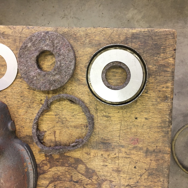

- Posts: 2
- Joined: Sat May 01, 2021 11:38 am
- First Name: Ross
- Last Name: Lumbert
- * REQUIRED* Type and Year of Model Ts owned: 17 TT 26 T Truck
- Location: Rose Hill KS
Re: TT rear axle outer seal?
Measured the parts for reference and future users.
The gap between hub and washer on end of tube is less than .125. I estimated 1/4-5/16 in previous post. See picture. After seeing gap it appears there is very little room for the felt under dust cap. You can see the edge of washer in picture.
Dust cap and felt dad installed. Pretty sure they came from Lang's. He bought lots of parts from Steve.
The new dust cap dad installed is 1 inch deep, estimated at 1.25 above. Looks like it should be driven all the way on to tube. Then install an x thick felt seal.
Comments?
Comments?
- Posts: 5400
There never was a felt under the cap during production. Felts have been added over the years but they are not original to the TT. If you do install or manage to install a felt under that short little cap, don't forget a washer for the bearing to rub on.
