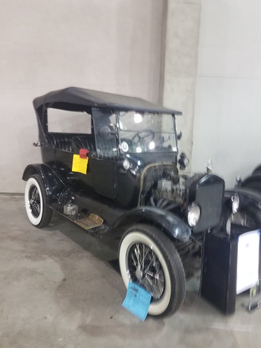

I just had these wheels powder coated. I am very pleased at how they turned out.
It would be difficult to sandblast, prep, and paint the wheels for the price I paid to have them done.
