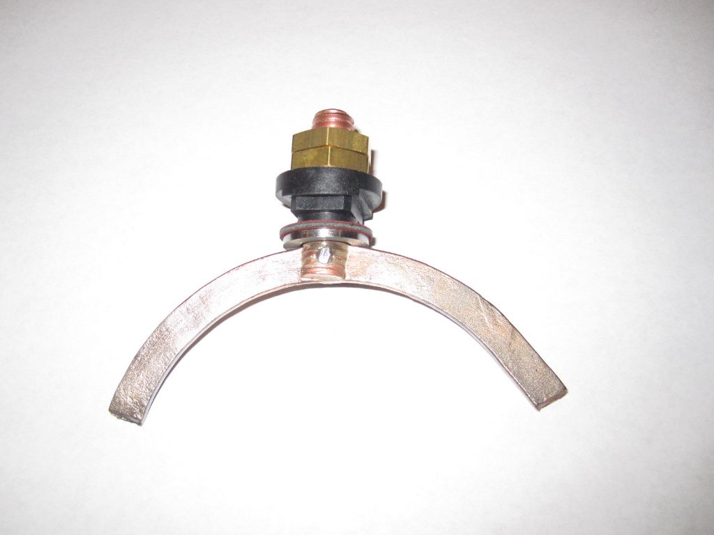

99% of the time if the battery is okay and the wiring is fairly decent, then the problem is inside the starter. The particular issue is usually a hairline crack in the solder bond between the terminal bolt and the field coil strap that goes thru it. You can sometimes even pull the cover band and see the hairline crack in the solder. I’ve fixed this in many dozens of starters. Usually everything else in there needs attention too and also bearings, seal, cleaning, etc, so rarely have I “only” re-soldered that connection. I’ve even found it on a couple “rebuilt” starters that were very nicely done inside with new fields, and very clean. Most of the issue is that the terminal bolt is a pretty fragile connection internally and because it is a fairly large “bolt” on the outside, most people WILL over torque it and the solder joint is the weakest link and eventually fails.
Ron Patterson
Re: Engine grounding
I concur with Adam on this one.
The most common internal starter problem is the failure of the inter-buss bar terminal bolt connection.
I wrote a article for the Ford Fix website on how to correct this problem and assisted Lang's Old Car Parts develop a kit to easily correct this common problem. Here is a link to the article: https://modeltfordfix.com/repairing-a-c ... r-problem/
You can buy the new buss bar and terminal bolt connection repair kit from Lang's. It consists of an entirely new buss bar and terminal bolt assembly that is silver soldered that will not fail like the original electrical grade soldered connection made by Ford.
Ron Patterson
