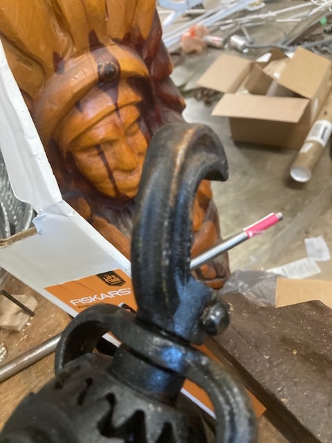

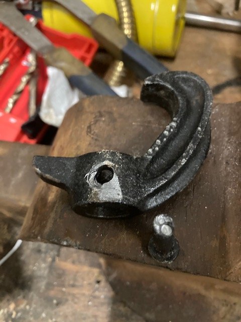

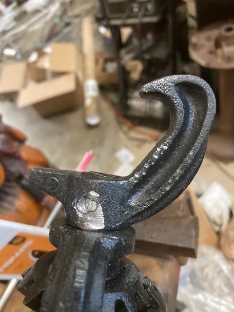

I have a personal problem. Every time I attempt to remove a rivet or pin it turns into a mess. When you drill or grind off the head the landmarks are gone. When the landmarks are gone it is tough to do anything drill or drive it out. Then you risk destroying the piece. My rim spreadèr has something wrong with it. I want to take the hook off and see if it is stripped or something in the way. I have been pounding on the pin in the hole I drilled but it refuses to budge and I don’t want to mangle the pin on the other side by grinding the pin head off and making another mess. This always happens everytime I try to remove a pin or rivet. It becomes a mess. What am I doing wrong?

That sounds good and I will try that in the future. So I put it aside, had dinner, came back to it and tried a smaller punch. It must not have caught an edge and the other punch must have been catching an edge because it started moving with the smaller punch.
Unfortunately I cannot find any obvious damage on the spreader. I think that the threads on the inside of the gear on the shaft or the shaft itself must be too worn out to catch the threads any longer.
