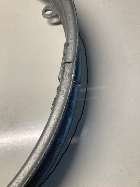

The good news is: one wheel is done I think. Does the split have to be perfectly together? See photo.
Otherwise: the arrow shaped wheel lock is much easier to get unstuck from galvanizing than the other style shown in the picture. In fact I have not so far been able to get the other style unstuck from galvanizing with Dremeling, heating wiggling, oiling, repeat and popping the handle a bit with a flat round punch (which works on the arrow shaped wheel lock). Finally, the new tube stem is bent after putting on the rim and taking it off. Is that a problem?
The bad news is: the second rim is kinked at the split so that the wheel just doesn't fit. How can I get it back to round?
The ugly is: my rim spreader broke some how. It worked at first just fine now it is very stiff to move the handle and it doesn't go anywhere. I think something is stripped but I don't see anything obvious on the threaded shaft. Otherwise: the arrow shaped wheel lock is much easier to get unstuck from galvanizing than the other style shown in the picture. In fact I have not so far been able to get the other style unstuck from galvanizing with Dremeling, heating wiggling, oiling, repeat and popping the handle a bit with a flat round punch (which works on the arrow shaped wheel lock). Finally, the new tube stem is bent after putting on the rim and taking it off. Is that a problem?

The Ford 21 inch split rims are made of surprisingly soft steel. They are easy to distort using rim spreaders, blocks, and pry bars. They are also surprisingly easy to straighten. I rigged a compass, and drew a couple circles on a piece of cardboard (one centered inside the other) to match inner and outer diameters of the rim so that I could lay the rim on it and see exactly where it was kinked. Then, using a piece of scrap wood between the tire bead channels (to prevent crushing the channels, guess how I figured that one out!) and the rails of my trailer's tongue, carefully applied pressure to tweak the kinks back into proper curvature. Almost any heavy iron framing with a gap of four to eight inches should work.
A car I had years ago had four really tweaked rims. The ends wouldn't line up, the latches (the ones that were there!) wouldn't lock properly. They would actually mount up, air up, and could be forced onto the wheel fellies with a bit of effort. So your question about "can they be run that way", is yes they can! But it really isn't a good idea. It took me barely over an hour to straighten all four rims once I had drawn the circles to guide me.
I wouldn't worry about a minor tweak in the valve stem like you show.

Thanks Wayne I will try the circle drawn with a compass check. Is the first one in the picture ok? The rim lined up very well by itself. Then when it went on it developed a substantial gap. But then when I aired it up the gap closed considerably to what you see in the picture.

Ignacio, You should be ok with picture #1 if you are using flaps. With split rims flaps should be used although Ford didn't use them from the factory. The bent valve stem tube in the later picture may give you some problems later on. The rubber stem tubes don't seem to be as good as a few years ago.

Ignacio, Hard to tell from the picture, but it appears that first rim is tweaked a bit. They can work fine if not too bad, however, sometimes the out-of-round turns into a bounce at speed. If the rims aren't too bad, the tire usually somewhat compensates for the rim's minor out-of-rounds. The comment about using flaps is a good one. Split rims should always have flaps. The tubes are vulnerable to two unseen hazards. Sunlight, which is pretty much eliminated while inside a mounted tire, and ozone. Ozone is an insidious gaseous oxygen molecule that creeps into even small crevasses and inner tubes don't like it. I have seen quite a few innertubes come out of tires on split rims where the spot over the split had failed in a nice straight two inch line. Flaps do a pretty good job of preventing that.

Ignacio, I recommend tweeking the rim to get it to line up. Looks to me from the pictures that it is the rim lock that is bent, the rim may or may not be out of round. When I change tires I find there is always a rim or two that needs attention: broken rim lock, loose lugs, loose rim lock. Most of those problems can be repaird by braising on the tube side of the rim.

Thank you for all the advice. I drew out a 22 inch circle and am checking the roundness. I've tried bending on my vise as that's the only thing I have that will more or less work to tweak it back to round. It so far is not easy to do. Here is a picture after some bending. Still not round.

I have about 3 and a half wheels now. A working rim spreader arrived in the mail just in time Friday to replace my broken one. That was very fortunate. I changed to MAPP gas to heat and free the remaining galvanized locks. The first wheel was not straightened and is slightly kinked. The second one was the worst of the bunch. I straightened it as well as I could with an arbor press but it still isn't quite round but round enough for the wheel to go on. I am giving up on that one for now. The third wheel was and hopefully still is round but was hell on earth to get the rim sides to line up. The fourth and last wheel flap for some reason kept on coming out which resulted in a wrestling match. The last wheel in the foreground was a 'Bimel' and looks very much like a Model T wheel and is very close but not close enough in its dimensions to fit. The wheel holes are slightly too low for the bolts to fit. I may have to get another front wheel and paint it. So I had hoped to get this done this weekend and have a rolling chassis. Close, but no cigar.
