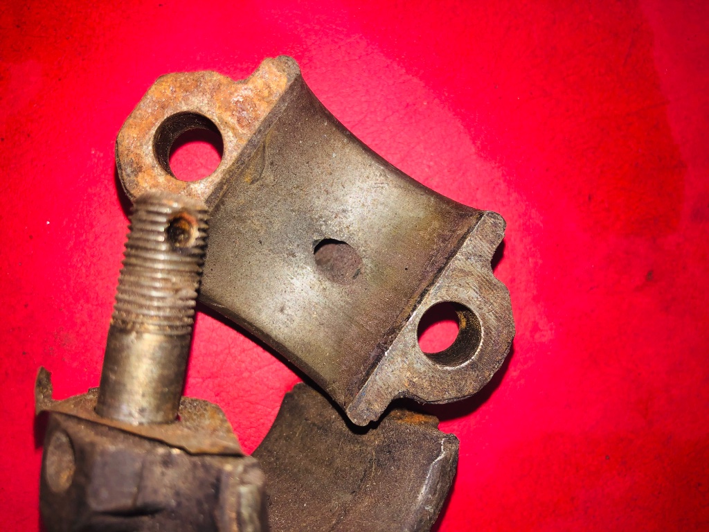

Late ‘27 Ford added dipper rods, the X type.
The dipper is angled to catch oil rotating , and the rod cap has angled hole with an oval hole in the babbitt, seems a good way to supply extra oil.

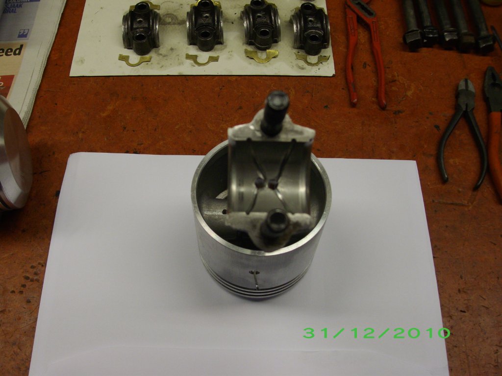

The Model A's 1927-1931 had dippers on the caps and X in the bearings. They also used splash for the rods and pistons, but had an oil pump to deliver the oil through the valve cover into the pan. They worked very well. I also have the dippers and X in my Model T's. I have no way to compare the life of the rods without the X and those with them, but mine work very well when the bearings are properly adjusted.
