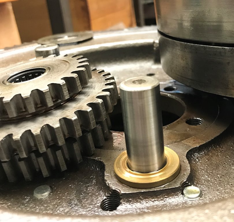

Actually I need to take exception to the comment regarding needle bearings in place of bushings in the triple gears. I recently pulled apart a transmission built almost 20 years ago with my needle bearing conversion in the triple gears. This the 1st opportunity I have had to inspect the parts after extensive use. You can clearly see that there is no wear on the pins. This is a case of needle bearings being applied to a properly designed and heat treated shaft.

We maintain the gear bore and the pin diameter on these to +/-.0002" per the manufacturers specs. Not sure of exact mileage on this one, but the car it was in belongs to a very active touring group in So. Cal. The reason for pulling the transmission was to replace the Turbo 400 clutch discs that were worn out. We have well over 100 of these conversions out in the world not including the new triple gears that we offer with the needle bearings and this is the 1st opportunity I've personally had to inspect a set after 25 or so years producing them. Needless to say, we're pleased with the condition of the parts. Unfortunately, I don't have a milage to report.

Stock pins are not reground. The pins are carburized chrome nickel alloy steel made specifically for this application. Attempting to reuse a pin of unknown alloy and heat treat is just asking for failure in my opinion. We have never really measured the radial play, as I said above we maintain the gear bore and shaft size to manufacturer's tolerance. My guess is the radial play is considerably less than .002". Play is almost imperceptible when the gear is on the pin. I have made some of these with a larger bearing that requires a much larger pin, which works well to salvage a flywheel where the pins have come loose and damaged the pin bore in the flywheel. I'll have a set of gears with me at the Tulare Swap meet this weekend in space K23.
