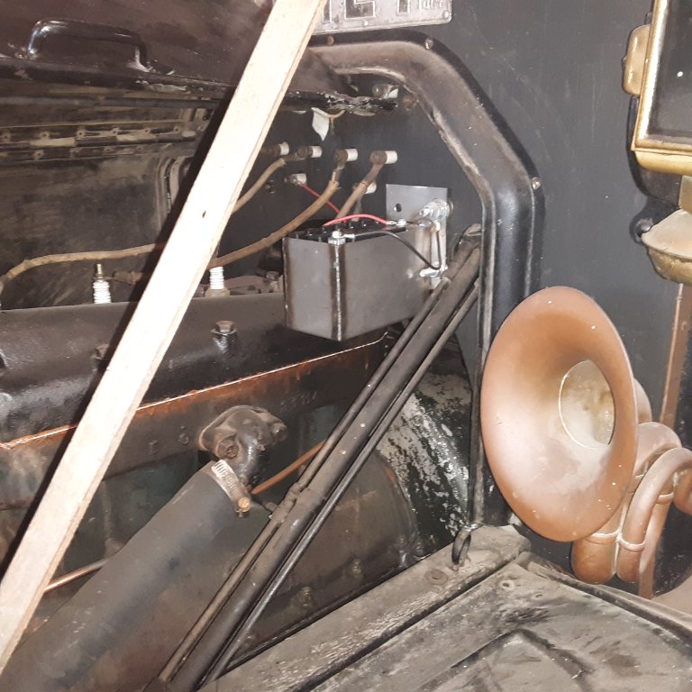

				got10carz
- Posts: 562
- Joined: Sun Jan 06, 2019 6:37 pm
- Last Name: Meixner
- * REQUIRED* Type and Year of Model Ts owned: 1911,13,14,19,23,25,26,27
- Location: Moorhead MN
Re: Battery mount location in 1914 car
This what I did on my beater 14. Way less wiring.
