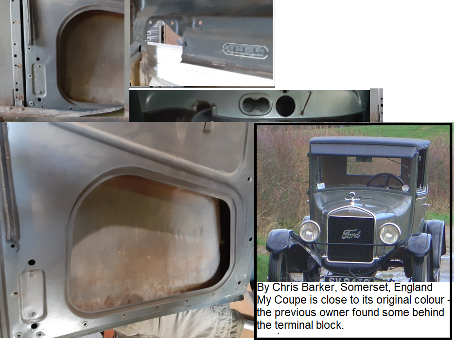

Jim, Would the last photo be what is thought to be "Channel Green'?

Yes. But that is only my opinion based on the fact that, to me, the color of the coupe in the last photo very closely matches the Channel Green color of the cars represented in the artist rendering in the four 1926-‘27 Ford ads, which are the most accurate depiction of Channel Green. Unfortunately, I do not know the brand or number of the paint applied to the coupe in the photo. Jim Patrick

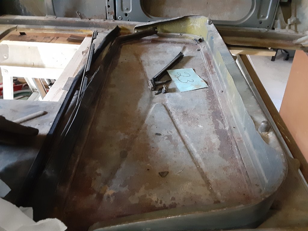

John-The data plate location on my unrestored '26 coupe (Bruce's 3rd photo) is centered side to side on the lower firewall and the two rivet holes are 2.25 " above the lower edge of the firewall. The rivets are split end brass, about 1/4" long. jb

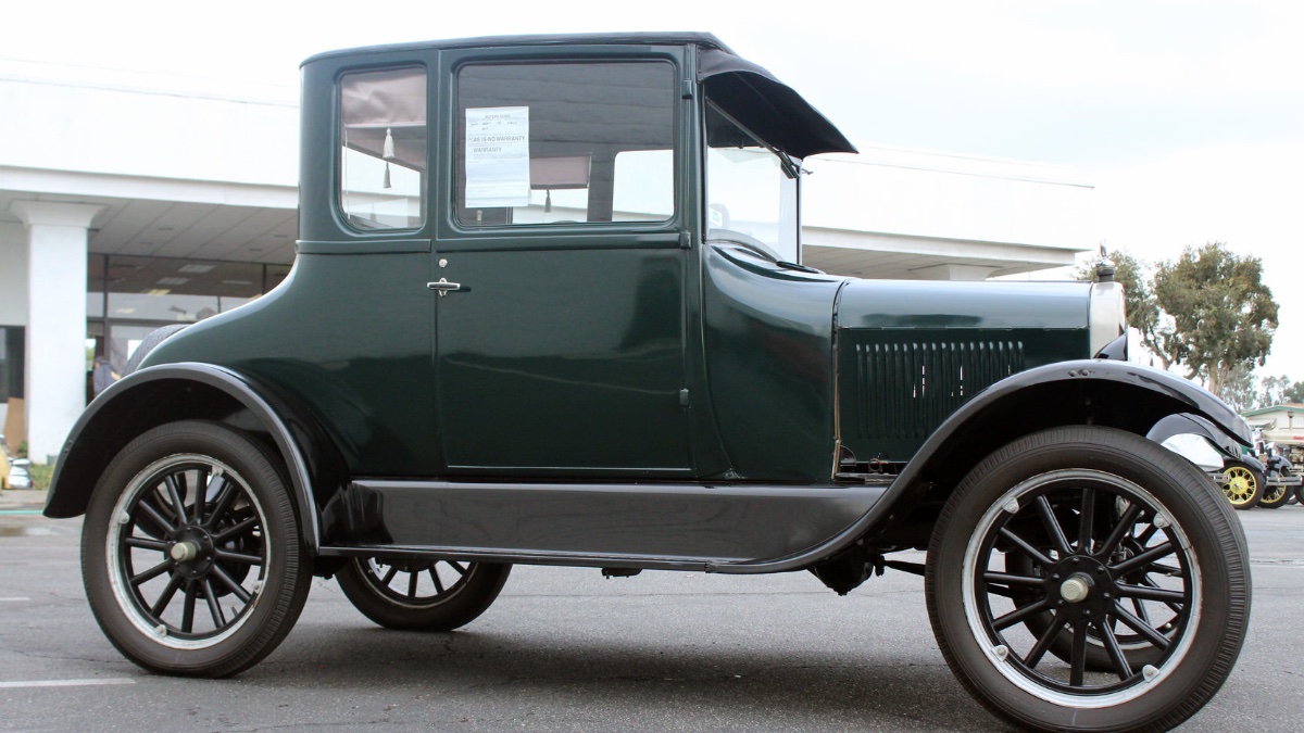

When looking at the photo's of the provided it appears to be a much lighter color green than what others have referred to as "Channel Green". So I am just asking if there is some agreement to the shade (light or dark) of "Channel Green" NOT the actual color.
Next Photo http://www.mtfca.com/discus/messages/29 ... 1201310982
Next photo

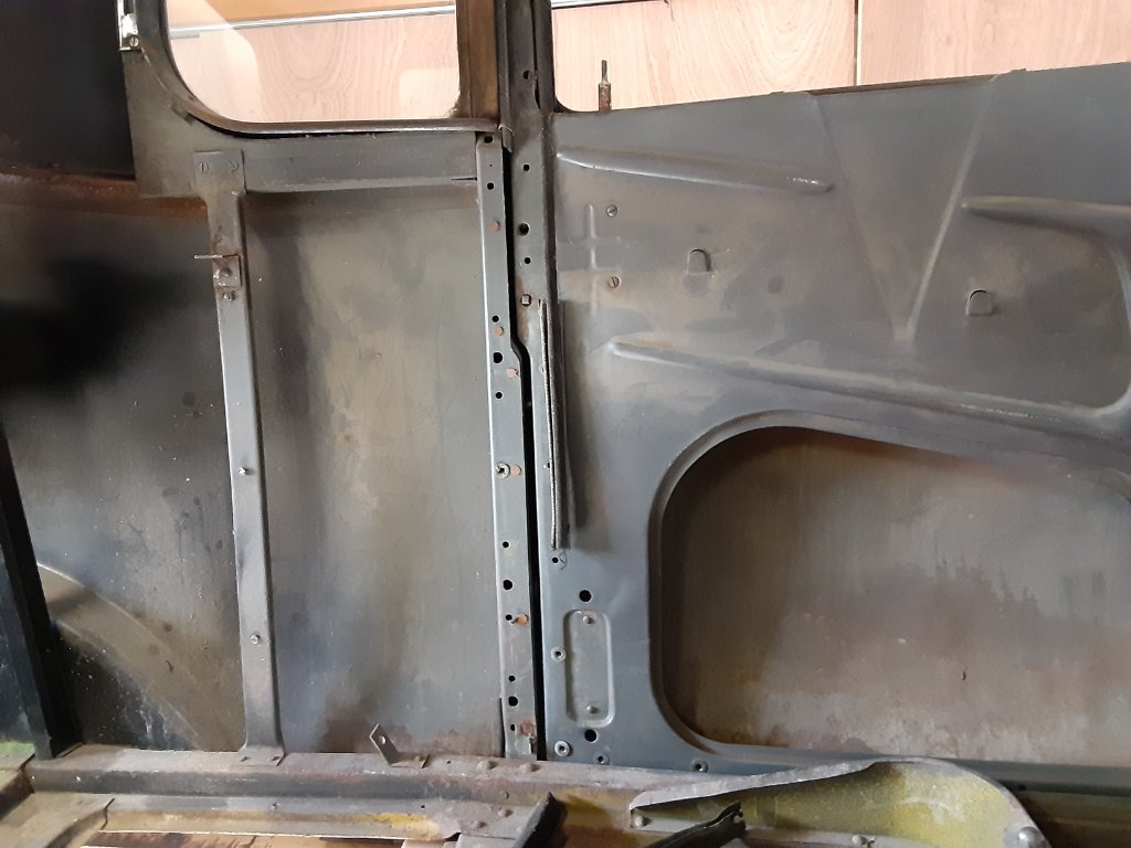

I am just restoring a 27 coupe right now. I am in second owner and it has been in our family since new. It did need a complete restoration as the outside had been painted up for a parade in 1967. I am going to paint the car completely black but the body was green. I have attached a couple pictures of the dash behind the interior light to show the color. I believe this to be channel green.
