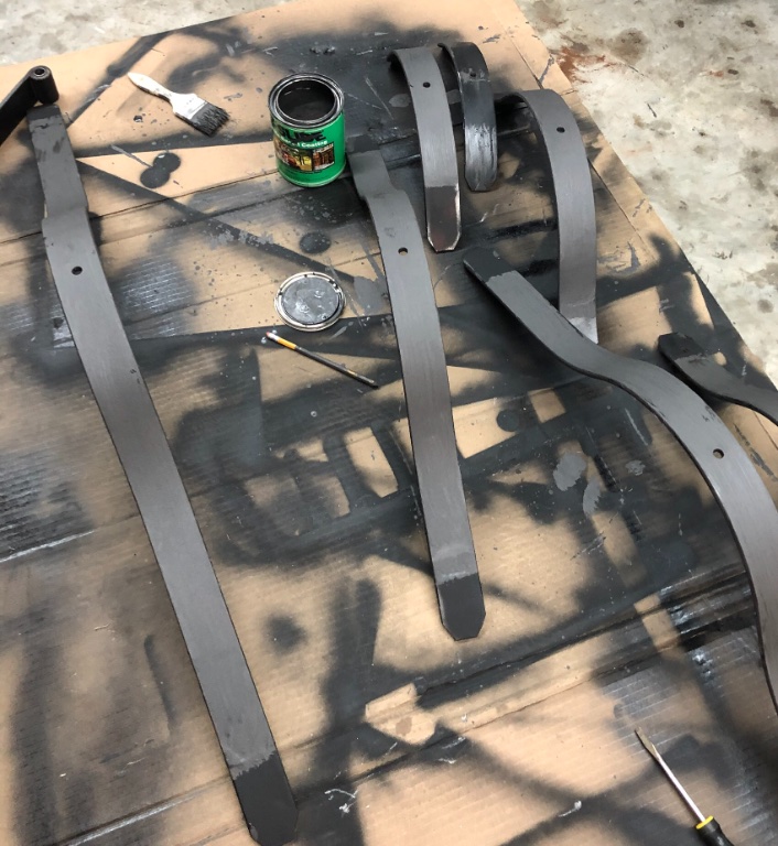

Painting springs some folks paint the whole unit assembled. I paint all the parts separately and apply slip plate on the bottoms of all leaves except the main one. I use phosphoric acid metal prep and paint with satin black rattle can Rustoleum. Some prefer glossy. I don't. It needs no primer. It looks good and is very durable.

Do you paint both sides of each leaf and then apply the slip coat?
I don't know if it's right, but that's the way I did it.
In the photo, note that I've masked the sides of the painted leaves so the slip plate goes only on the bottoms.
I should also give a heads-up on what not to do. Several years ago, after reading about it on the forum, I used UHMW tape instead of slip plate. That did not go well.

Note. If you do not paint the leafs and elect to paint them with slip paint, be sure to paint both sides of the unexposed areas of each leaf instead of just the bottoms. Jim Patrick
