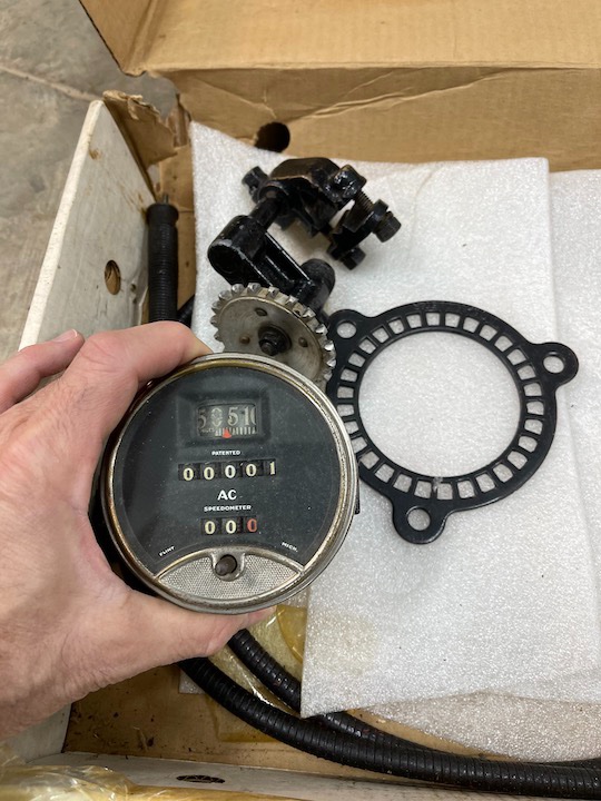

So I bought this speedometer at Luray. Trying to ID it. I can't find a company name one it. Unless it's AC. Anyone recognize it?
Is the large ring (I have one) universal?

It is an AC unit. Very nice. Vast majority are blown pot metal. Very hard to find one usable.

I'm reading about the problems with them now. I hope I didn't buy an expensive paperweight. Not sure how to test it. Could I hook up the cable and use a drill on the other end to spin it?

You could try the drill, but slow goes it in the correct rotation. Try rotating with your fingers first to make sure it is not binding up. There are other AC heads that will work with the setup you have. Just to be sure you know, it goes on the left front wheel not the right. No one that I have found rebuilds this type of AC heads. I used one like this when I had my AC setup; https://www.ebay.com/itm/373569013236?h ... ondition=4 There might be others that will work.

If you can turn the drive end & the dial rotates freely, its probably ok. Sure turn with a drill. You might consider sending to Russ F. to service & lube before running it.

The AC speedometer was made with pot metal internals, and at the time of production, no one expected these units to last, let alone work, after 100 years. Unfortunately, the pot metal used to hold the aluminum speed cup on a AC speedometer warps and swells, making the units unusable. You can determine if an AC speedometer is usable by checking out if the speed cup drops to zero easily, and when the speedometer is shaken gently, does the speed cup move easily. Unfortunately, you can see the speed cup on this AC is sitting at around 3-4 mph (not good). I always caution people about using a drill to see if the speedometer is "free", and I have had to rebuild speedometers from owners who had used a drill in this way. One hundred year old grease does not work too well, and it is just better to talk to a person who rebuilds/restores old speedometers BEFORE using the drill.
In all the years I have rebuilt speedometers, I have seen about a half dozen First Series AC units that worked following restoration.

Well what do you know. I gave it a little tap with my hand and it went back to zero. So I know I'm not out of the woods yet. Won't know until it's opened up.

Russ was kind enough to have me do a test. He said to use a drill and see if it jumps all over the place it's no good. I'm not sure if this is what he means so I'm hoping he'll have a look. It seem to move fast but is that because of the drill speed. I had the drill in reverse.

Rob, After looking at the video, the speedometer cannot be repaired. The pot metal frame that holds the speed cup is either warped or broken, making the speedometer a "shelf" item. I'm sorry for the bad news. Russ Furstnow

Well I gave Bob's Speedometer's a call to see what they do since they list AC as something they work on. I spoke to Bruce. He said that they do make the pot metal parts out of bronze as well as machine some of the original parts. However, it wouldn't be cheep. If he had to make the three parts in the spedo that are made of pot metal it would be around 1500.00. The big part of the price is time. Having worked on clocks before I know why it costs so much to have a clock serviced. Making everything right takes a lot of time. Russ' advice of putting it on the shelf is probable the best. Sadly I paid 400.00 for it and it was my mistake for not researching before I bought it. So am I mad? Nope. I don't think the guy who sold it to me knew there would be a problem. For now I'll go with my phone speedometer app and concentrate on getting Rattles back on the road.
