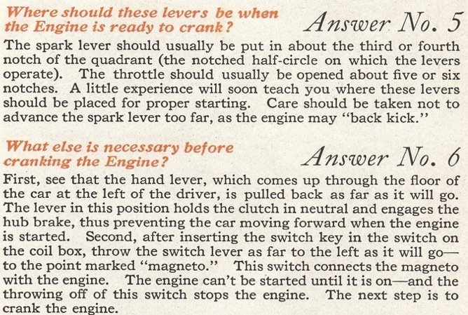

Here are the Ford recommended spark lever positions for easier starting on Magneto power only cars. I.E. no battery.
Ron Patterson
