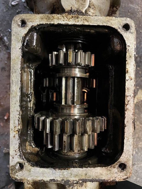

I am attaching a photo of the gearbox. The gears look to be in good shape , no sign of chips or damaged teeth. The gears slide wasily on the dogs with no binding or excessive play. I checked the forks and they do not appear to be bent or twisted. i then clamped the shifter in a vice and heard a definite clink going into all gears except first or underdrive. So it appears to be a problem with the shifter. I did not disassemble the shifter assembly but it looks to be moving all the way forward so the one road is even with the edge of the case. just not clicking into place. It also find a have something to do with the custom shifter tower. I did find an aluminum warford shifter assembly on Ebay which I ordered. so I will check this out when it arrives.
Thanks for all the help.
Dan

Those gears look New!! That tower sure looks like somebody made it? Sometimes the little steel balls and springs get sticky with hard grease for not being used.. Since it has evidence of modification I'd check to make all the balls are actually in there with the springs..
The very early Warfords used a threaded plug instead of the little cap and a cotter pin. That set up could be adjusted for spring tension.
If after you install and drive it you might see some oil leaking from around those shifter rods! World Famous T Racer ED Archer showed me how he attached and encased the ends of the oil leaking rods with copper tubes! I do that with each Warford for the guys here to prevent lots of oil leaks.
Just in case... I have an extra shifter tower
