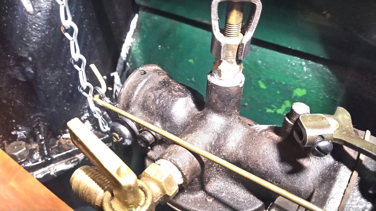

Re: NH Radiator Choke Rod End Bend
That got me started..
I could not get the Long Tail Z Bend to start into Arm 'Eye'.. So I bent a little different.. A Little bit of a challange to thread through the Rad Hole, but a little wiggling and it goes..
This is a Short Arm NH. Dan's Pic looks like a Long Arm Carb.
Cap
Cap
