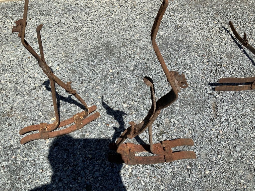

That looks like a 28-29 Model A bumper. The brackets are probably not correct either. Here are pics of an extra set of rear bumpers I have from a 27 Touring car.

Here are the bumpers mounted. I hope this helps. Russ Furstnow
