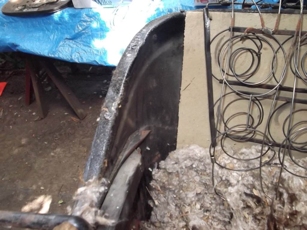

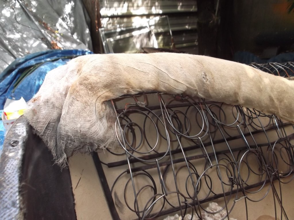

I was given the front seat section of a 1919 or 1920 touring. It looked like the upholstery had never been off. The back cushion was hung off the tack rail, there was a piece of upholstery card stock between it and the body, no other support. The bottom cushion is; 17-1/2" X 36-3/4" (44.45 X 93.345 CM). If you need the front seat back rest, I can get that later.
