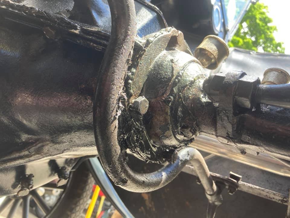

Bolt check
- Posts: 5110
Re: Bolt check
And its wired? Threads must be severely stripped.
- Posts: 4618
Re: Bolt check
I can’t tell if that’s grease or black rtv silicone sealer that’s oozing around the ujoint area. Also the lower left bolt is either stripped or backing out. That’s an area that causes a leak and can be a pain. It could be it needs a shim that’s available to put between the ball joint area that tightens it up a bit.

Re: Bolt check
Both bolts tightened up fine..It looks like someone forgot to tighten them in the past..threads seem fine.

Re: Bolt check
The heads of the two lower ball cap bolts should be wired together:
http://www.mtfca.com/discus/messages/41 ... 1393081993
The upper two bolts have castle nuts and a cotter pin.

Re: Bolt check
Some of it IS silicone...I'm thinking I should disassemble and clean up that area.John kuehn wrote: ↑Sun Jul 04, 2021 4:10 pmI can’t tell if that’s grease or black rtv silicone sealer that’s oozing around the ujoint area. Also the lower left bolt is either stripped or backing out. That’s an area that causes a leak and can be a pain. It could be it needs a shim that’s available to put between the ball joint area that tightens it up a bit.
- Posts: 6707
Re: Bolt check
That little unused clip bolted to the frame should have a fuel line running through it.
