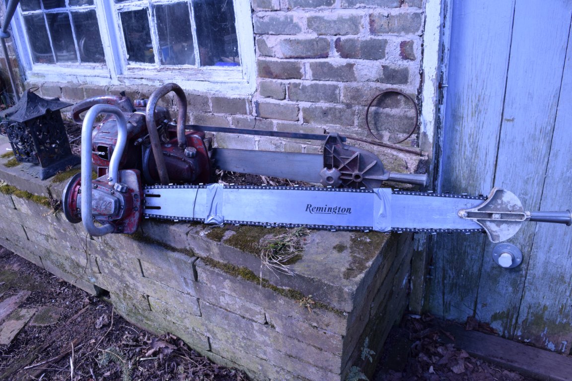

Yes bar oil is the best. I just replaced all my chassis oilers. Had some help.
