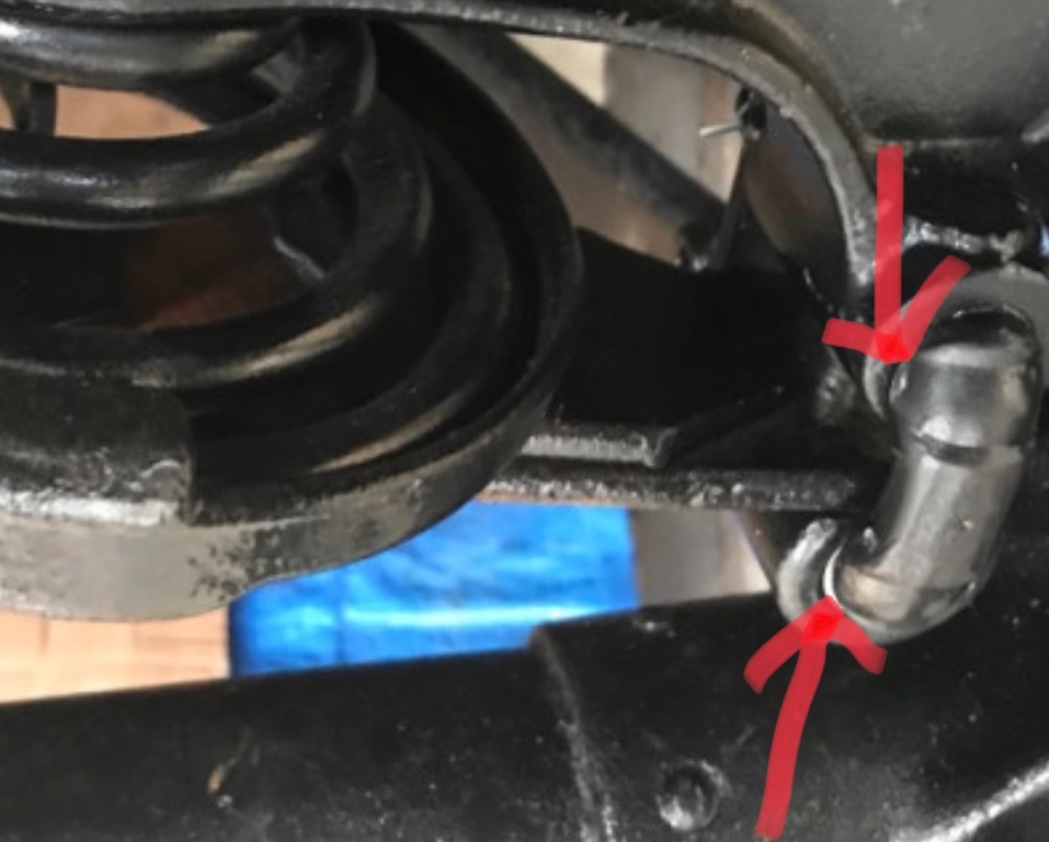

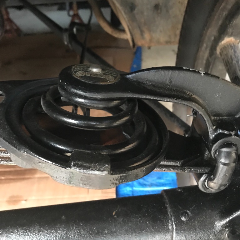

Is there a trick to accessing the flip-top oilers now mostly hidden underneath the rear Hassler shocks on my ‘24 touring?
Do I need to remove the shocks?
Gene
Gene

If you lift the car body by the frame with like a 4x4 in the rear, the axle will drop down and open up the spaces between the coils. May work, just a thought. Frank
- Posts: 6800
Re: Flip-top Oiler Under Rear Pancake Shock
a large screwdriver that you don't care about and a hammer, or a cold chisel or any flat bar and a hammer will fix that right away.
apply oil to the ensuing hole

Gene, those guys want you to work up a sweat. Just put some oil here on both sides, it’ll wick in where it’s needed. Your bushings look plenty good from the pic.

I'd combine Tim and Scot's suggestions.
- Posts: 5254
What I see is the flip top oiler on top of the spring. It appears to not be set down far enough into the spring as designed. Even without hasslers, there is typically only 1/8" clearance to open & oil. Oiling via the bushing ends is a good way to go, as suggested.

Actually, I have the exact same shocks and find it easy to oil those flip tops by using one of those little plastic oil bottles that are sold by any HVAC supply. You can pull out the long little plastic tube from the bottle, and easy to place oil about anywhere. Squeeze the bottle and you can see the oil move. ( mix a little bar oil or STP with it ) That’s easier than the needed calisthenics trying to use the metal ford oil can.
