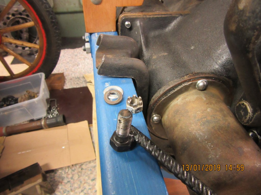

Re: A Solution To An Old Problem With Firewall Bracket Hardware
Bob , I do it this way :

- Posts: 7700
The block looks like a good idea to me. I would chamfer the top edges of the block slightly to avoid to possibility of their wearing a notch in the frame rail over time. Some anti-squeak on both the top and bottom of the frame rail at that point might be a good idea. Some movement is bound to occur when the car is in motion, and probably needs to to avoid cracking the sheet metal. I would not weld anything to the frame rail.
