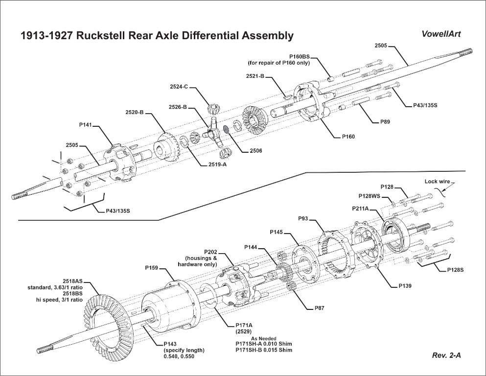

Maybe some of you been wondering what I've been up too....well, I've been busy sure, but I was drawing also, I thought I had a customer, but since they backed out I thought I'd post them here for the good of the hobby.
These drawings give you the correct part numbers for ordering parts from Chaffin's Garage, because there are no vendor part numbers for these items other than the steel thrust washer 2529 that is used between the Ruckstell Differential Bell and the Differential Housing Assembly and the common rear axle parts for the Right Side of the axle housing.

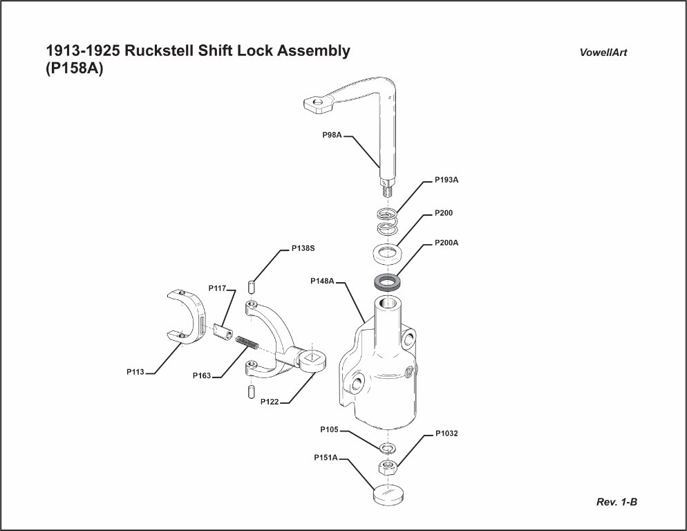

1913-1925 Shift Lock Assembly.
1913-1927 Ruckstell Differential Assembly
The differential is exactly the same from 1913-1927, so I didn't see the necessity of making another drawing for what is primarily the same darn thing. Now some of you may wonder why I've not included that fiber washer that everybody was mentioning the last time I asked questions about the Ruckstell Axle....well, the reason it is not on this drawing, is because I WAS drawing these for Chaffin's Garage, but as of today found they've no use for the drawings and so aren't interested in them at all. But this doesn't mean that I regret drawing the Ruckstell Axle, no, they needed to be drawn regardless because they are part of the Model T Ford legacy, even though they were an "after market" product, but then so are a lot of the carburetors I've drawn also. So, if any of you want to furnish me with the dimensions of that washer, I could add it to this drawing as a boxed item.

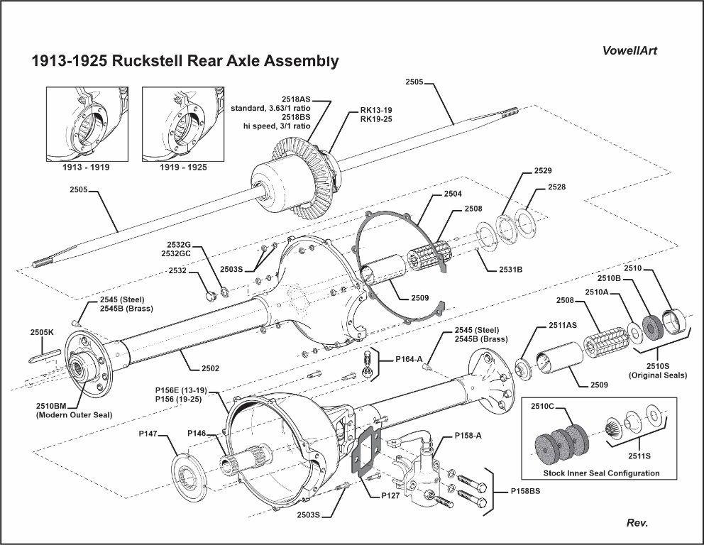

1913-1925 Ruckstell Rear Axle Assembly
The Rear Axle Assembly is also one of those that is pretty much the same as the 26-27, at least internally. It is the exterior that changes with the taller Shift Lock Assembly and of course the 26-27 Backing Plates....what was really surprising to me is that there are 3 different 26-27 versions of the rear axle assembly. I'll reference the different part changes and when they occurred on the 1926-1927 Ruckstell Rear Axle Assembly drawing.

I can’t help you on the fiber disc. But Let me say thanks for doing all of these drawings.
In a past life I was a draftsman, and I really appreciate the time and skill it takes to make such drawings. They are awesome and sure to help model T fans for years to come.

Art, I don't see the sliding clutch. Is it hidden under the sun gear?

In your drawing, the axle assembly with the ring gear is faced in the opposite direction of from the axle housings. The large portion which contains the planetary gears goes inside the wider housing shown below it. Otherwise the drawings are excellent.

Norman, the bell goes into the standard axle housing, not the Ruckstell housing, because that is where the clutch sliding gear is and that has to go into the Ruckstell housing to mate up with the Shift Lock Assembly that is bolted to the outside of the Ruckstell housing. The Ring Gear is in the same position as it is on all Ford Axles....also on the Ruckstell side of the differential there are no pins for thrust washers and the bronze bushing. The shifting end of the Ruckstell has a very large Thrust Bearing that fits into the housing. Which means that the Bell with those pins sticking out of it are for the Standard Ford housing on the passengers side of the car, because this is only place the thrust washers 2529 and the bronze bushing 2528 are.
The Clutch Sliding gear isn't on the Differential drawing because there is nothing to attach it too. You may buy it that way but that is not the order of assembly. It seemed pretty obvious to me that the Clutch Locking Plate (P147) had to be shown installing into the Ruckstell Housing and since the Clutch Sliding Gear (P146) can't be assembled outside of that plate, but actually goes through it from the interior side of the Housing, it had to be shown on the Main Axle Assembly drawing and not the Differential drawing.
I am actually making a cross section drawing that shows the Clutch Sliding Gear and what it engages with when the that gear slides in or out.

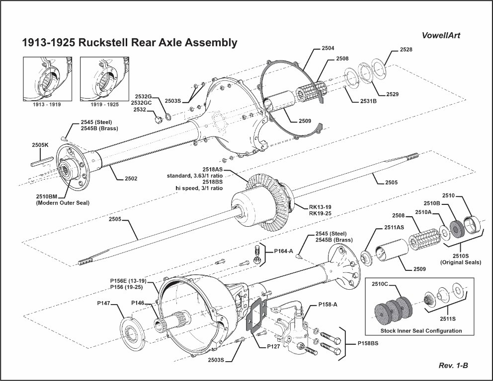

Ok, going back and looking at the 1913-1925 Ruckstell Rear Axle Assembly, I decided that the drawing as presented was a bit confusing, so went back and rearranged the elements a bit to take out as many of those bloody compound "dog legs" as possible...a dog leg is a necessary thing in my drawings, but multiple bends aren't a good thing and can lead to some confusion as to what is being presented.
Hopefully this gets my meaning across better than my first go, by cleaning up the guidelines some. The parts placement hasn't changed (since they're in the correct positions for this assembly already) but the elements shows more clearly (I think) that the Bell goes into the Passengers Side Ford Housing and that the Ruckstell Differential side goes into the Ruckstell Housing (drivers side).

1) The 2526 diff gear spyder must have the ends shortened to fit into the Ruckstell spyder gear housing. The stock Ford part will not work without modification.
2) The Ruckstell high speed gear set was a 13/40 (3.07:1) gear set- not the 13/39 gear set sold for many years by Mark Auto.
The drawing are wonderful! Thank you so much for your work!!

Dan, that may be so, but I'm not telling you what needs to be done to stock parts to build up a Ruckstell Axle. All I'm doing is showing you how the parts go together, that's all any IBP (Illustrated Parts Breakdown) does.
As for the ring gear, I drew these originally for Chaffin's Garage and this is the info they had on the ring gears they sold...if there are others available I don't know anything about them, but if other vendors sell these other ring gears I'll add them also to that drawing. Chaffin's doesn't sell everything other vendors do either, for instance they don't sell John W. Stoltz Distributor or his brake system either, that brake system is far better than those damned-able Rockies, but at the time I was thinking "larger brake drum = better braking power"...but with Stoltz's system, Heavy duty drum with Kevlar lined shoes = superior braking power....and they're not the much more noticeable from the ford standard drum, just a bit thicker, but nothing like looking at that cluuge called Rocky Mountain Brakes. The old ones like Larry Smith has work in both direction and will hold you on a hill....but these new Rockies only work in 1 directing (forward) and won't hold you on a hill at all and if they get wet they may not stop you at all.

Just a curiosity thing, but original Ford parts books list the USA ratio as 3-1/13 to 1 and Canadian as 3 to 1, no mention of teeth numbers.

You might be right, however, why is the left housing so much wider? I am not going to take mine apart, however, to inspect it. I can see from the position of the ring gear on your drawing, it is positioned to go forward when driven by the pinion gear.

Oh yes I see the the sliding clutch now.. I missed it earlier .
Thank you.

Ok, here's that change.
