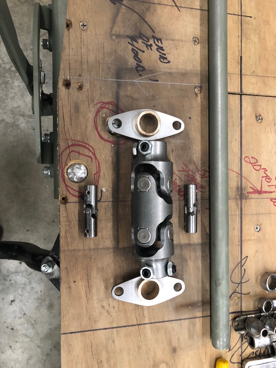

Now do not throw out those old triple gear bushings. They have a recycle fee in doing this as well as the brass rear cam bearing too. I drill out the supports from 1/8" plate making the center hole 7/8" and the two control rods 5/16". Those triple gear bushings work the best, then machine the ID to 3/4" slip fit on the shaft and a step from 1" to 7/8" OD. Look at the photos you will see a very light grove cut on the back side. I use this to tack weld a bead right on the brass edge. This method acts as a great retainer. You could use a external snap ring but I am keeping the bushing from spinning by the tack welds.
Now after welding them into place I split the column length wise as since we are installing these u joints and are requiring more space.
Now for a pre-fit. GOOD!

Don't forget that yokes of U joints must align to the same at the other end. The little 5/16" ID X 1/2" OD U joints can be expensive like $50.00 each, OUCH! Check the bay under light commercial supplies, they occasional appear at half price or less. I am making cardboard templates later of some of the pieces if you folks want. But I am burning a lot of daylight lately so bare with me.
Will be showing the attachment with upper cage access in the next couple of days!
This column will have 19" from floor to center of steering wheel. Dave is using a flip up fat man wheel so this will work great! Since he will be using a high performance carburetor, we are converting the hand throttle into a choke lever and reversing the quadrant to the top for leg clearance.
