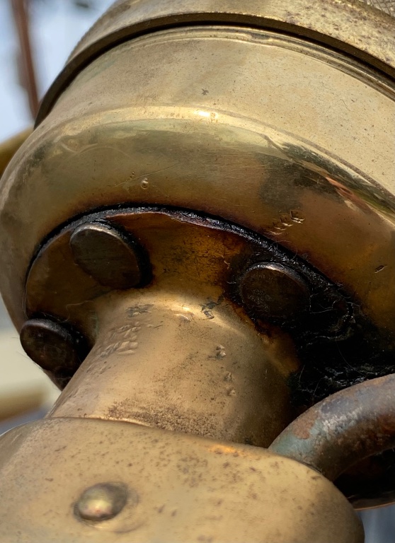

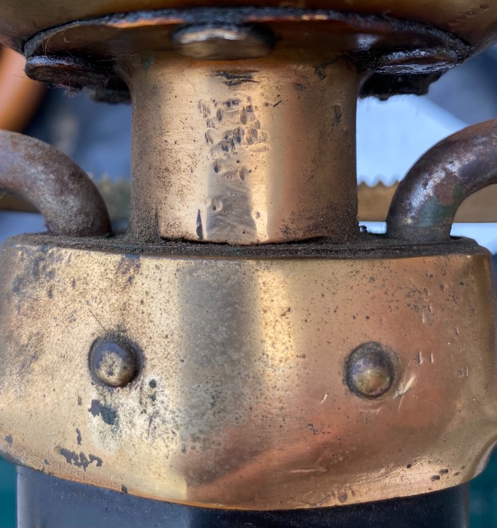

Yesterday, Saint Westminster helped me replace the six brass solid rivets in my 1911 steering column cup without removing it from the car. After and Before pictures below.

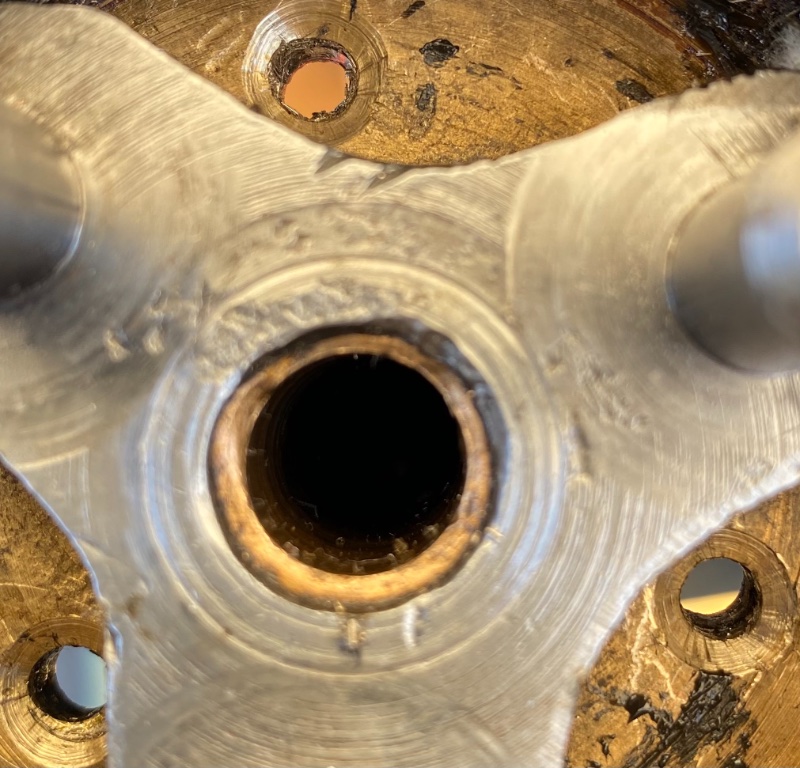

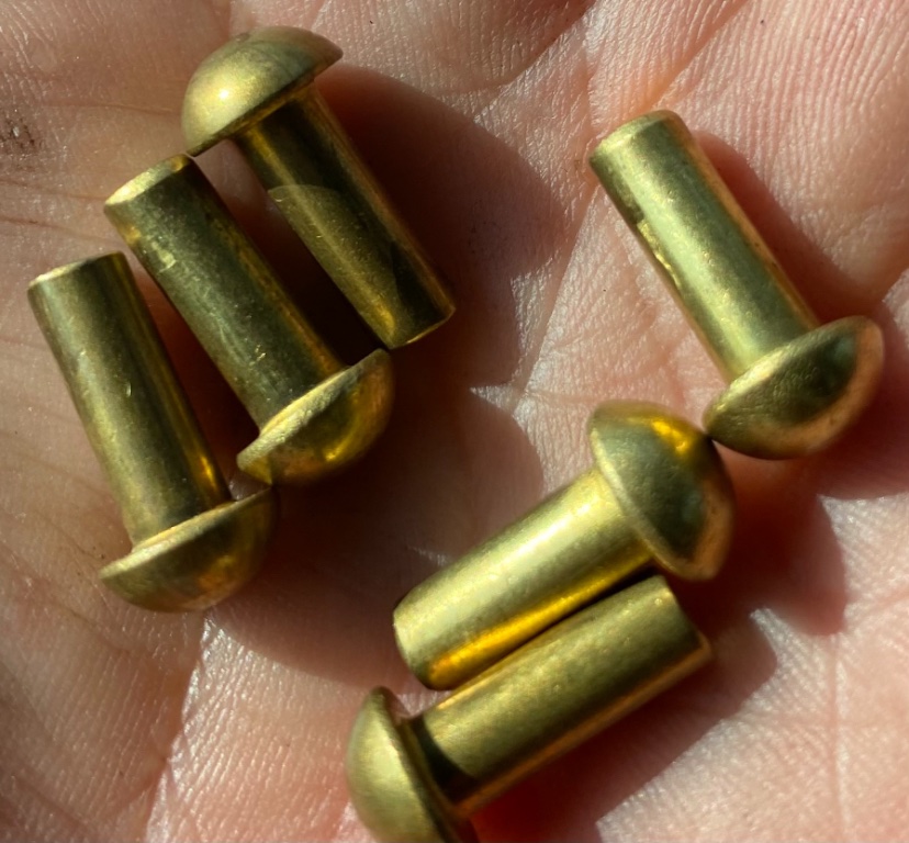

Step 2; We slightly enlarged the cup’s rivet holes to a size 1/1000 smaller than the “oversized” rivets that I got from Chaffins Garage. This drilling absorbed the oval shape rivet hole deformity caused by decades of back and forth steering sheer forces. We finished these holes with a slight countersink flare to accommodate the spreading of the rivet foots. Otherwise, such flattening of the rivet foots inside the steering gear cup will interfere with the steering shaft head.

AFTER, ROCK SOLID
AFTER, ROCK SOLID
BEFORE, LOOSE AND UNSAFE TO DRIVE

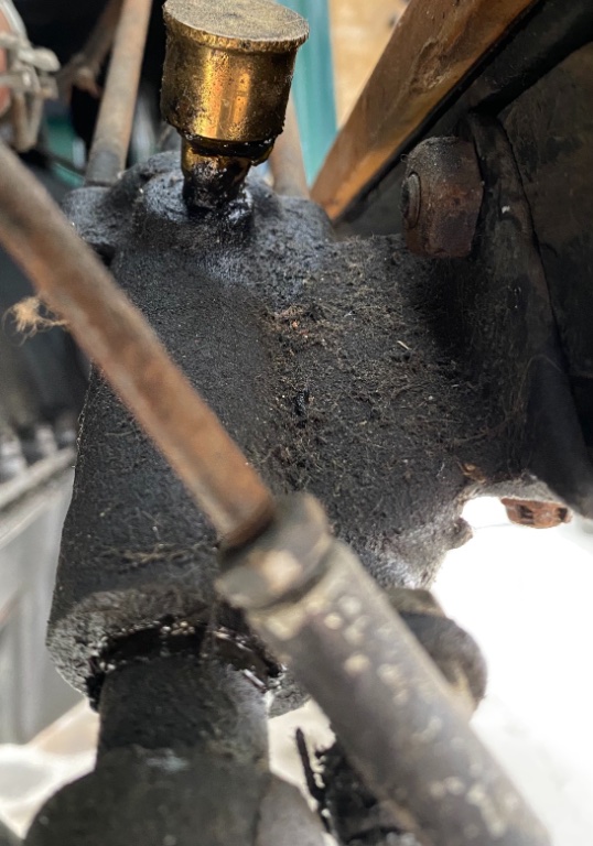

Under the hood

Custom fabricated off-set hammer-gun bit and 20lbs backing buck sculpted to reach the back of the rivets without removing the steering shaft. Made one XXL rivet from scratch to fit a particularly worn out hole.

In any case, those photos will show the custom turned hammer gun bit that he is heating with a torch (photo above) bent at its impact end to attack the heads of the rivets through the throttle rod and spark rod assembly. The opposing "buck" was simply a heavy chunk of steel rod turned down on one end so that it could fit in-between the nodes of the steering shaft head and onto the rivet foots inside the gear cup. It weighed about 15 lbs. There is a photo of the freshly prepared rivet holes between the steering shaft head nodes above.
