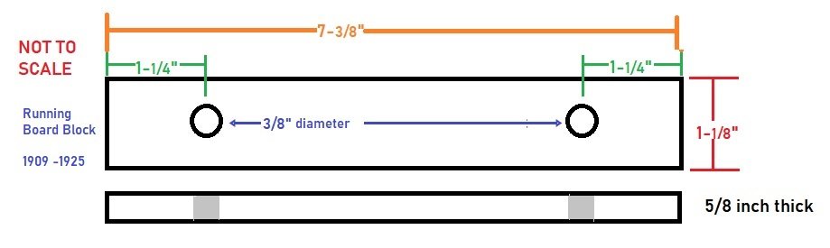

Here are some drawings. I have some running board blocks - will measure and add to this response
The TT steering block is higher to fit in the frame channel

Thats the ones. I need the one for the rear which has an odd shape to it.

Here is some additional information.
This info below is from this link http://www.antiqueautoranch.com/montana ... yBlock.htm
