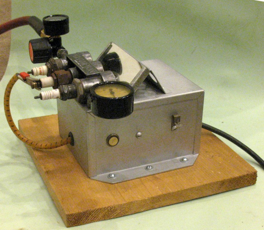

Bron, after receiving your email asking about a transformer and where I got it looked for some record of both and found nothing. So after being reminded by your post this morning I had the brilliant idea of actually looking at what I have.
This is the tester as it came to me. It was an extra that Dean gave me when I stopped at his place on my way home three years ago. It was a Hershey find.
Here I have cleaned up the inside and installed a new power cord. The original 1932 transformer is still there, but I had to replace it after one of the terminals broke off and I was unable to fix it.
Here's a current picture with the "new" transformer in place. It's obviously an old one. Unfortunately I have no memory or record of where I got it. Maybe I bought it online, or maybe it was a donation, or maybe I found it in my extensive collection of junk. It has four leads. The white wire in goes to one of the two primary leads. The black wire in goes through the button switch to the other primary. The line power in is the standard 110 volts AC house current. I assume the two secondary leads are 12 volts, but I can't say for sure. One goes to the top (timer) contact on the Model T coil. The other goes to ground on the case. So does the coil's bottom contact.
The restored tester with a new air pressure gauge and regulator.

I never thought of it, but I expect a model train transformer would work just fine. Ideally it would fit inside the case, but I suppose you could use it externally if it's too big. One wire would go to the coil's top (timer) contact, the other would go to ground on the tester case, and a third would go from the coil's bottom (strip) contact to also ground on the case. Of course the spark plug wire attaches to the lower side contact on the coil.
