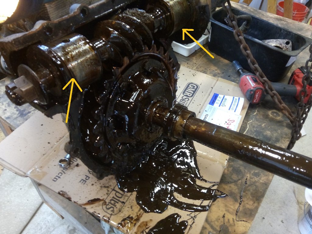

Post by A Whiteman » Fri Aug 20, 2021 5:26 pm
We could not push this TT either. It is a 'barn find' in beautiful original condition with a lovely locally made Kauri wood cab and deck.
Under the gunk the hyatt bearings on the worm drive shaft were rusted and seized. It looks like water had entered the upper worm housing and sat there for some time. Cleaned and replaced with 'spares from the box' this one runs well now:
