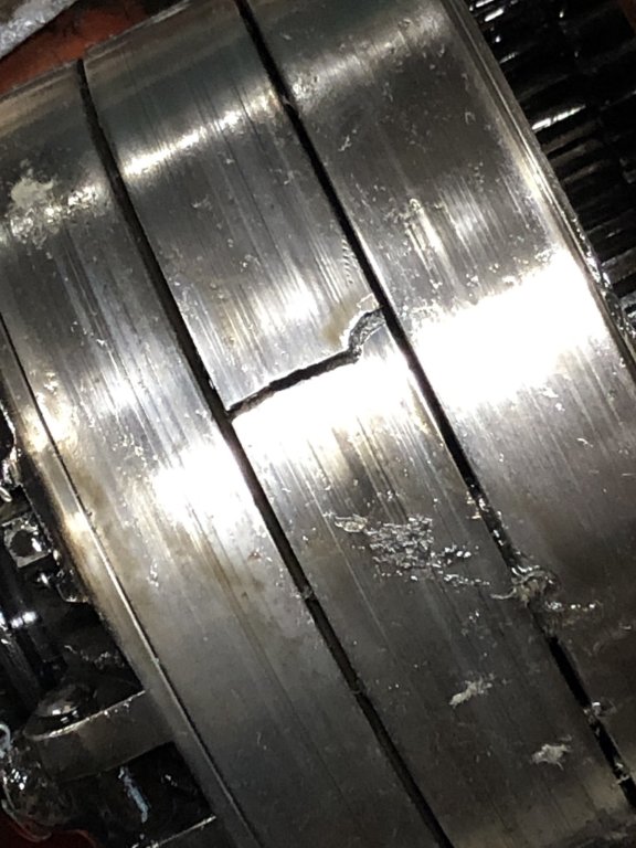

I developed a knock on the first day of the national tour in Spokane, WA.
That put me in the trailer and sent me home.
Pulled the engine and this is what we found.
This is the first time that I have had a broken drum presented itself as a knock.
The drum is cracked across the face and one adjacent web is cracked.
The break stands proud almost 1/8"
The rods and mains are fine.

I have been running kevlar bands for over 30 years.
On the tour I adjusted the Brake band.
I can not remember the last time I adjusted the Low band.
I know it has been at least five years since I last adjusted it.
Respectfully Submitted,
Be_Zero_Be
I drive a Model T ... Microseconds don't matter :D

Transmission drums can fool you into thinking that they aren’t cracked. As others surely have found when you pull down an engine and check the drums and they look good. Closer inspection sometimes reveals small cracks in the webbing thats most likely been there for years.
Good luck and it’s another day in the life of a Model T.

It might not be the fault of the present driver. If this is an original drum, it could have started to crack many years ago, and then finally at just the time when the driver pushed down on the pedal, it cracked.
I learned a lesson about mine when it broke. When I had previously re-lined the brakes, I noticed the low drum was blue. Then one day, I was out for a drive, and when I started out in low, the car suddenly screeched to a stop. I couldn't even get out and push it. Fortunately my son was home and quickly came with the truck and trailer and a rolling floor jack. We jacked up one rear wheel and winched it onto the trailer. So, if there is anything suspicious about the drums when you have it apart, that is the time to replace the drum.

It probably started a long time ago and finally progressed until it cracked on the working surface of the drum.

The web crack occurred where it was drilled when the drum was balanced.

Looking at your drum, it also appears a majority of the web was removed. Was that also done to try and balance it?

Wow Bob! You didn't just dodge a bullet, you dodged the whole magazine. Sometimes it's hard to know when to stop when balancing drums. I take some out of the web but have never drilled one like that. I guess there is a lesson to be learned from it.

Those lightening “dimples” do not follow any of the typical lightening guidelines that allow for the removal of material without significantly affecting the overall part strength, i.e. hole diameter no greater than 1/3 width of material, at least 1 diameter of material between holes. If done that way, through holes might remove more material while retaining more strength than the part shown. The lesson here is that balancing is good, but not done in a way that sacrifices significant part strength.

It's pretty clear why that failed the way it did. A drum that has had too much material removed from the face due to wear or re-machining would be more likely to fail, also. A drum in that condition could heat up very rapidly at the rim and thus be highly stressed. Removing any significant amount of material from the web area is not a good idea, since it reduces the mechanical strength, thermal mass, and thermal conductivity of the brake drum. If material must be removed, the surfaces should be left smooth and rounded, with no grinding makes, notches, corners, etc. The portion of the casting at the outer edges of the holes in the web that run under the rim should never be altered.

I reviewed the video and agree that adding weight to the drums is a better method of balancing.
Looking more closely at my drum, I tend to believe that crack across the face occurred first some time ago.
This allowed the segment between the crack and the following web to fatigue the weakened web.
As I recall, the knock occurred suddenly - probably when the web let go.

Done right , a balanced transmission is a joy. This "balancer" obviously dont know how it's done. The holes are a NEVER no,no. The webbing is way too thin also. I suspect the casting was way off center. First step would have been to lighten the opposite I.D.
Cant blame kevlar for this mess.

Some drums are a bit beyond balancing by removing metal. If the casting is poorly centred at the time of manufacture, it may require so much material to be removed that the part is compromised, as it was in this case. The best answer is to find another drum. The new ones are much better balanced, being CNC machined.
